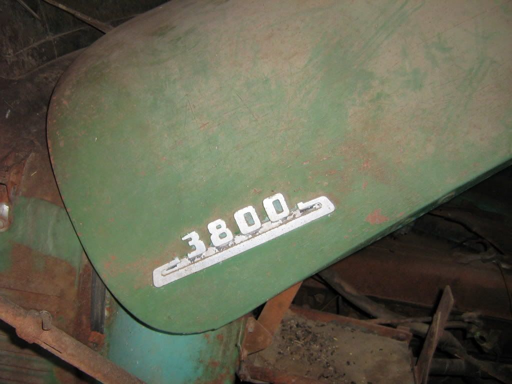

Finally enough guilt to break the wife down. I'm going to try and purchase this '53 3800 Flatbed Dually from a friend. It's been in a barn since the mid 70's. I'm thinking about offering $500 for it. It appears that it has been repainted but I am not sure. I am also not sure if the engine is a 216 or 235.
Check out the pictures and let me know what y'all think. Identify the original paint and engine for me.

It's been repainted. This picture shows a light or maybe aqua blue under green. You can see the same difference on the firewall and along the engine compartment in this picture. I think the engine is a 235.

The paint wasn't very good on the days that truck was built and they were repainted every few years. It is very rare to find one that is original paint. It does look like someone put a rear axle from a one ton under it which was also very common to get more weight carrying capacity. It looks like a very likely candidate to restore. It's probably been in Texas all its life and never seen a salted road.

I looked at paint schemes from that era and believe it was originally "Ocean Green" which matches the firewall color. Somebody else told me that they believe the rear axle had been modified.

Yes, they came with low pressure 235's. Only the engine ID on the raised pad next to the distributor can tell us if it has been changed. The axle my be original with an adapter, but it has likely been changed out with a modern one. The rear rims don't look like splits, but the fronts are.

Ocean Green is a 1953 color.
The 235 engine with that valve cover did not become available until 1954.
The radiator housing was chopped-up to allow the radiator to be moved forward - the later 235s (late-55 through 1962) had a water pump that extended too far forward and would have hit the radiator. That engine is a later 1955 to 1962 engine (most likely a 235 but it could be a 261).
