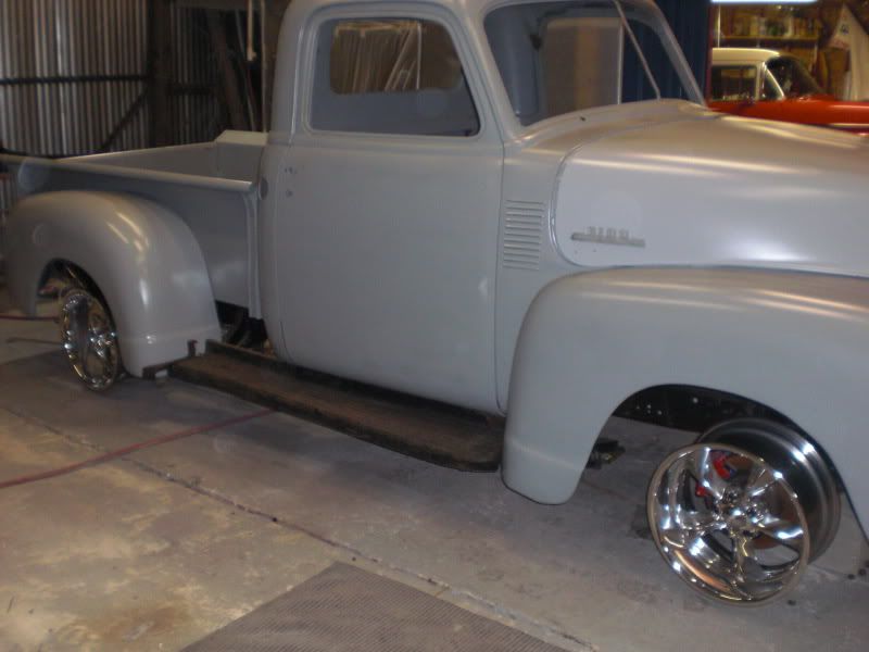

been a while since I updated. all the sheet metal is temporarily hung. my new wheels are in. boyd smoothies 17x10 rear and 17x8 front. I also have the seats and am building the mounts for them.
with my torgue thrust wheels from my vette just for mock up

new wheels and tires on
http://i11.photobucket.com/albums/a198/ahsum/005.jpg
http://i11.photobucket.com/albums/a198/ahsum/crusin047.jpg
