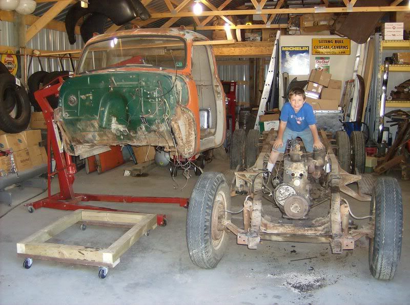

Hey 53, I just did my second cab and it's really easy. Here is a picture from yesterday. I had made an extension arm which goes in the end of my engine hoist. I got lazy and didn't want to put it in so I got a 2x6 and beefed it up with a 4x4 in the middle. I put it as far forward in the door openings as I could and it balanced perfect. It was so easy, I'm going to make a better version of my quickie lift mechanism. And yes, I removed the cab alone!

55 First Suburban... Why didnt I think of that? Great idea! You need to make up a bracket swivel thingy and market it.

I know, it's really simple! I'll be welding up a mount and support system soon. I'll post pictures for everybody when I do.
