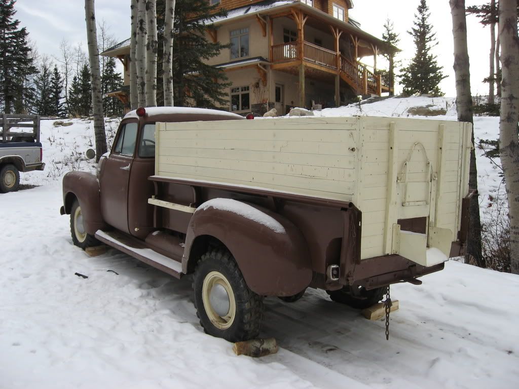

Here is a link to an album (17 pictures) of the 1951 1 ton I hauled home a couple of weeks ago from Scratchy-bum (that's 'Saskatchewan' to our southerly friends). I hope the link thing works, I couldn't find a linking option for Photobucket that didn't require at a minimum a thumbnail picture.
After posting this message I found that only the one picture was 'shared' and that I didn't make a link to the album.
[IMG]http://i272.photobucket.com/albums/jj191/Braggck1/1951%20Chev%201%20ton/th_IMG_1776.jpg[/IMG]
I was re-reading the recent thread on heaters and unfortunately my underdash heater (picture # 16) doesn't look like a standard Chev model, either the deluxe or the recirculating variety.

I am so green with envy that you found a 1 ton, single axle, dump bed, body in good shape, AD truck.
This truck picture has just won my award to be placed as my computers desk top image for the next month.
CONGRATULATION!!!!!!

Thanks very much! I told a couple of my friends that I'd bought an old truck with a dump box and the reply was a scornful "What are you going to do with a dump truck??" The next several seconds was like an old clip of Moe tuning up Larry and Curly.
I don't know if the photobucket link will work, but here's what they claim is a link to the album with the rest of the truck pictures. I'm not very good with internet stuff, but perhaps by trimming some of what looks like excess off either end of the url it may get you to the album.
<a href="http://s272.photobucket.com/albums/jj191/Braggck1/1951%20Chev%201%20ton/?action=view&current=IMG_1767.jpg" target="_blank"><img src="http://i272.photobucket.com/albums/jj191/Braggck1/1951%20Chev%201%20ton/IMG_1767.jpg" border="0" alt="engine bay left"></a>
The truck spent it's whole life shedded on a grain farm in SE Saskatchewan, and it was used on a decling basis until about the mid-80's. Then one of the family members did a cosmetic restoration, knocking out some dents and repainting it. That fellow then died in an accident, about 20 years ago, and the truck was put back in the shed until recently when the current family members decided to sell the farm. In that interval mice destroyed the seat upholstery and the headliner, but other than that it's in remarkable shape. For grain hauling they put a sheet of 1/8 steel in the box, over the wooden bed floor. From underneath the wood planking is still there, but I haven't lifted the steel yet to see what the top of the planking is like.
Due to the condition of the truck I plan to do only a 'limited' restoration (lots of mechanical stuff, not so much with the cosmetic) to make it safe to drive (interior to original colors and materials, repair the brakes, suspension, and any drivetrain issues, etc., leave it a 6V, and repaint it the original "Commercial Maroon"). I think there's a place for a truck with some time-earned patina.
I'll post a note every now and then as she progresses.

Yep. Nice truck, very very similar to mine - except for the corner windows, which are making me pea-green with envy. Here's a current(more or less) pic of Epic #2, with next summer's load aboard:[IMG]http://thumb11.webshots.net/t/60/460/2/93/35/2357293350096215731NILUKV_th.jpg[/IMG]
I've had this truck since the middle of '06, and as you can see, the work is in progress. My end plan is about the same as yours. PM me if you have any questions about what I've done, why and how.
p.s., your link didn't work. I don't know why, but someone on here does.

What a lovely machine! Where was this pic taken? Looks more like Bragg Creek than Regina. The apparent condition of your acquisition bears out my belief that Saskatchewan might be the world's best place to go looking for an old truck. Have you driven it yet? That looks like road dirt in one of those pix. When I got mine, it had its original differential ratio; 5.14, which rendered a comfortable cruise of about 35 mph, a fast cruise of 40 - 45 and was nearly flat out at 50mph. I like 50mph, but not with the engine screaming like that. It was okay at 50 with this load on it, [IMG]http://thumb11.webshots.net/t/59/159/2/44/83/2992244830096215731VRvwTI_th.jpg[/IMG] because the engine was working, but fuel economy was abysmal. I never thought to gauge it, but I think that since I've changed out the differential it has increased by nearly 50%. I now have a 4.10 diff, and the truck is now a reasonable candidate for a road trip, because it can cruise easily at 50 - 60mph. I have been staying close to home since the change, but have driven enough to know that there is no ill effect from the change. She can still pack a monster load, could still (hypothetically) pull a big boat up a ramp, or crawl dead slow over a field of rocks.

"AWESOME TRUCK" Grendel, Can't wait to see pictures of it with the dump, in action. These 1 ton pickups, are "Neat". I purchased a '50 GMC 1 ton pickup last year.

Okay, I'm back from the motorsickle foolishness. Shaken, stirred a little, and thoroughly chilled.
Tires: Yours look good in the pics, so maybe you won't be doing anything with them for a while. Mine were rotten, so I set about looking for replacements for the original 7.50 - 17". I wanted radials, but what I found was mostly nothing. The only choices were bias ply, at vastly inflated prices. I considered them, but soon enough came to the conclusion that since my truck was to be road iron instead of an occasionally-driven museum piece, I had to go with my instinct as a trucker and upgrade all the way around. What was readily available and not overpriced was 235/80R16 tubeless. Superior in every respect except for originality. I had to change the rims as well, and found used aluminum rims which pleased me for the same reasons. Painted 'em black for effect [IMG]http://thumb11.webshots.net/t/52/452/5/7/74/2835507740096215731EDCLJS_th.jpg[/IMG] and added a bit of chrome to set it all off. What I had then was a smoother, quieter truck which would pack more load with fewer tire failures than I could expect from OE.
Those are some gnarly looking skins you have on your drive axle, Grendel. They look tactical. Are they?

Hey guys - The picture Hotshoe asked about was indeed Bragg Creek, by comparison in Regina when your dog runs away you can still see him running three days later.
And if this truck is any indication of the quality of old trucks from Saskatchewan then it is definitely the place to be snooping around, it seems like a lot of the old farms are changing hands and they are often being consolidated into larger farms, which should mean redundant old trucks needing new homes.
The PO said he started the truck when he listed it for sale, though it hadn't been started for 20 years prior. I wanted to try and start it when I got it home but I was thinking I should remove the gas tank and get it cleaned out, and replace the fuel lines first. My garage is being used by the 'regular' cars until the worst of the winter cold is past, then I will bring the truck inside and see what's what. I've got my fingers crossed that the 20-years-ago work included a rebuild of the front suspension and brakes, but I should just be grateful for the condition of the body.
The tow home was prenty hairy, mainly due to a blizzard and slick road conditions for the first half, and even when the road was good I didn't go over 55 mph. That said, the laden trailer tracked straight as an arrow, and the ride back sure was better than that awful back-and-forth jostling that happened every time the empty trailer hit a bump.
Those back tires really are the business, with the knobbies going right up the sidewall they look like a motocross tire done large, which would be good for that Saskatchewan loam mud. The sidewall says "Goodyear Studded Supergrip, 7.50 - 17, Heavy Duty 8-ply rating". They're pretty cracked so I'll be looking at Hotshoe's approach to wheels and tires.
The motorbike show comes to town this Friday!
