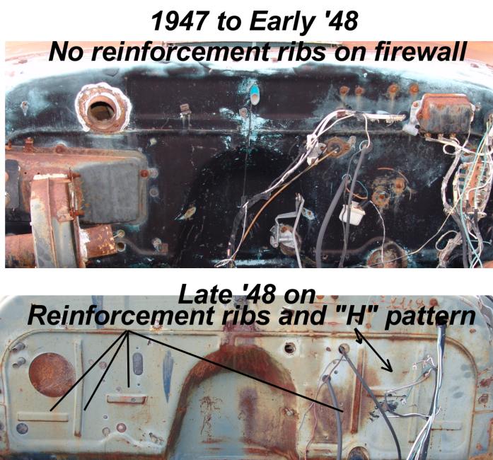

As for the body, since you have the gastank behind the seat if it has a side cowl vent it's either a '49 or '50. Look at the firewall in the engine compartment. If the indented areas on both sides are smooth, it's a '49. If there are strength ridges stamped in them it's a '50. 2 ways to tell if it's an early or late '49 is the center strip in the headliner and the cab windlace around the inside of the door openings. If the strip is held in with screws, it's early. Late had the floating type. If the winlace is held in with cilps and screws, it's early. Late had the slide in the track style.

Would you be willing and able to post here or mail to me a few pictures of the 1949 firewall that distinguishes it from 1950 and later trucks? I would like to add this to a list of distinguishing features for A-D Chevrolet trucks (and I will reference your assistance).
That change was supposedly made in late 1948 on GMC cabs. Here is a photo made by Rob English for GMCs:
Change in GMC firewall in late 1948
Tim
