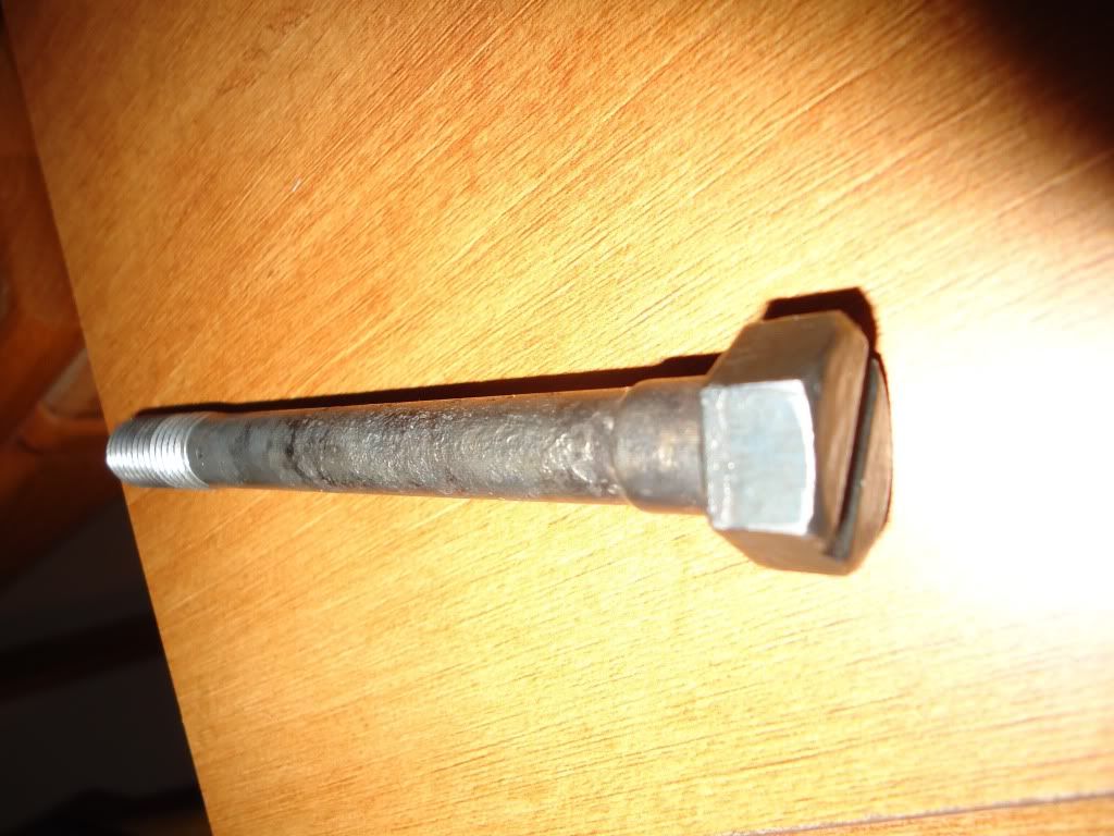

I'm searching for clarification. I have a 1960 235 with the 848 heads. There was a terrible mess under the valve cover (rat's nest) and so I've started a cleaning operation. When in there I found that no oil was getting to the top of the head. I pulled the rockers and rocker shaft to expose more area to clean and noticed a head bolt to be sticking out and not flush with the surface and I have no idea why. Could it be the infamous drilled head bolt and if so would it be sticking up like that as an adjustment to the oil flowing through it? Also, the oil tube that supplies oil to the rocker shaft seems to have a crimped end on it and I'm not sure if that is stock or if someone before me altered it.

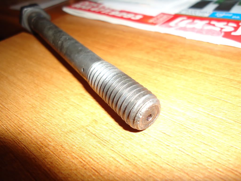

I answered my previous questions except for why the copper oil tube line is crimped on one end.
I have also located the drilled head bolt. It is the one with a grove across the top. It can be seen in the following pictures:
http://i281.photobucket.com/albums/kk214/PirateYarr/1957%20Chevrolet%203104/Rockers/DSC00375.jpg
http://i281.photobucket.com/albums/kk214/PirateYarr/1957%20Chevrolet%203104/Rockers/DSC00378.jpg
Also, It's location, now knowing what it looks like, can be seen in the rocker assembly pictures linked in my earlier post.
It was very corroded and the hole in it was completely clogged. I cleaned the hole but I'm not sure how to clean the part it mates to at the bottom of the bolt hole. Theorizing, if the bolt hole was clogged so is this other oil passage at the bottom of the bolt hole. Any suggestions on how to clean this to get the oil flowing once again?
