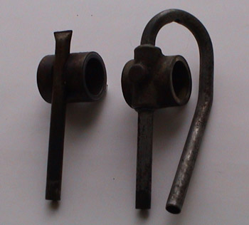

I have a 49 3100 with a 54 235 in it (I think!)
With the valve cover off, I see a short, curved tube in the middle of the valves that is about 2 inches high and curved - like an upside down J. What is this? Is this some sort of oil return line to splash oil on top of the valve train? The end of the tube appears to be somewhat "crimped" closed - looks like it was mashed closed with pliers? Should the end be open?
Also - can I turn over and/or start the engine with the valve cover off without making a mess?? (throwing oil everywhere?)

That is the oil return line for the excess oil that does not go out to the rocker arms. YOu can run the beast with the valve cover off. Not too much mess with my 216----I don't know how much oil is slung around in the top of a 235

Here's a dark photo of what you're talking about. The one on the right is from my '53 235. I don't know if it came from my truck's orignal 216 or with the newer 235. The overflow tube lowers the pressure to the rocker arms.
The one on the left is from an "848" head of a newer 235. GM crimped the overflow tube.
I have a third one where someone has crimped and brazed the overflow tube.
[img]http://www.sandeace.com/48/OilConnectors.JPG[/img]

I've seen a lot of discussion about these things, but I have yet to hear weather they should or should NOT be crimped. I took the crimp out of mine. 235 w/848 head. Am I wrong?

The idea was to relieve excess oil via the tube but you cannot possibly over oil the rockers so I leave 'em crimped shut when I find 'em like that
As long as oil indeed comes out the tiny hole in the top of the rocker when you rev up the engine you're good to go ~ no oil at all indicates a serious problem you need to address _now_ .
