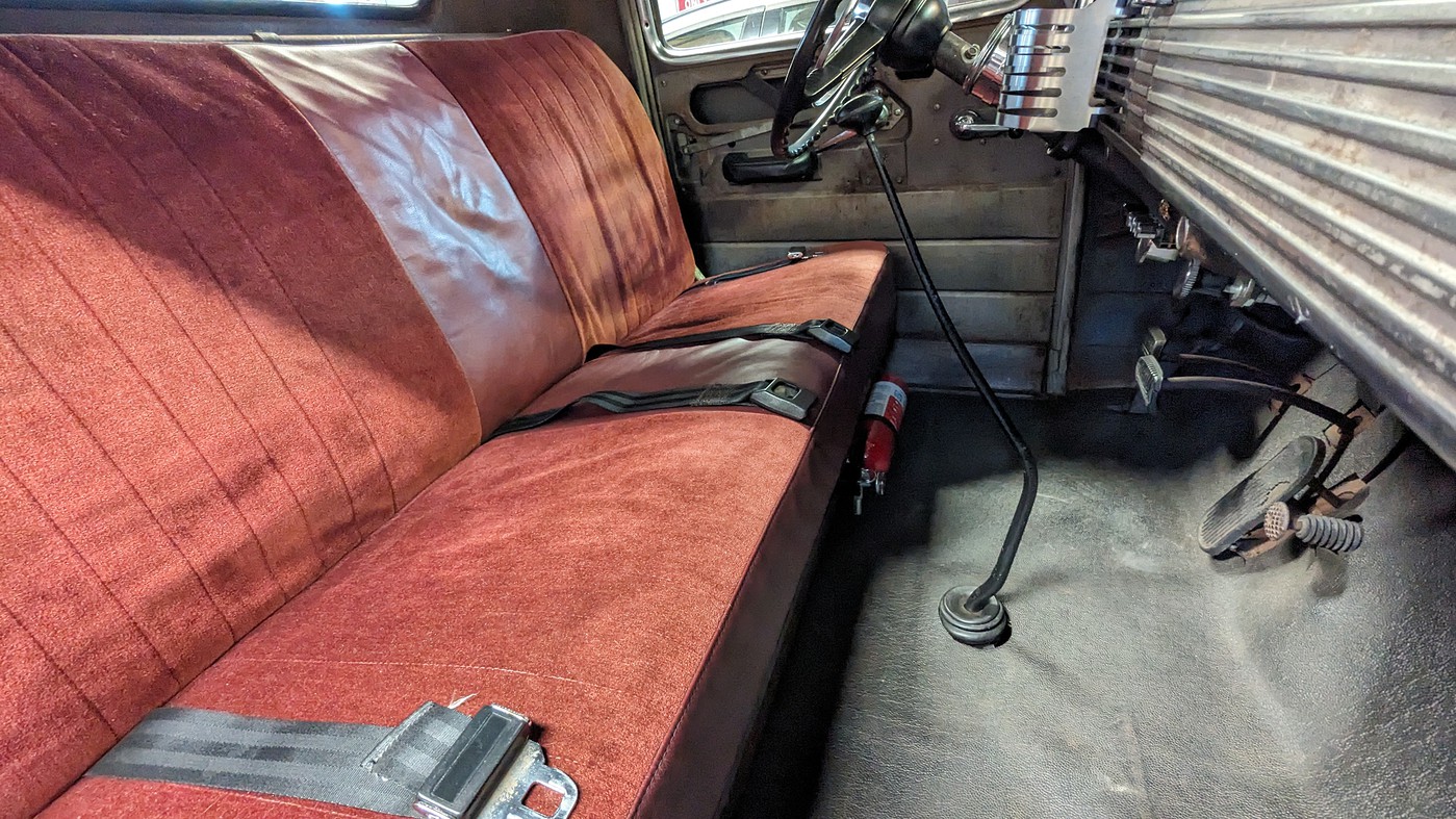

Mike, can you post pictures of the T5 you have, and give the tag number (1352-XXX)?
The S-10 tail housing shifter location puts the shifter here in an AD truck with a stock bench seat. [PICTURE] The stick I used came off a junk SM-420 four speed and was welded onto the T5 shifter mechanism.
