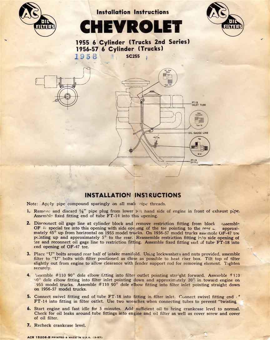

I am not getting any oil out of this lower port to be able to monitor oil pressure.
What would cause that? Its not clogged. I took out the hard line and cleared. No obstructions.
Inside the block is clean too.

Looking back, originally it was at the rear port.

Your not alone in here. Was meaning to respond yesterday but family stuff got in the way. If you check out this Oil filter line diagram from our Oil Filter Tech Tip you can see the forward port location is meant for the oil return line connection from the filter. It would be blocked off if yours doesn't have a filter installed. The rear port is the one where your oil pressure gauge was and needs to be connected. If you install a filter, it will need an adapter to allow for the oil filter pressure feed line to the canister in addition to a port for your pressure gauge line. Hope this helps. wink

Thanks Dan! Yes I found oil pressure at the rear port. It where the canister had its inlet. The one I had it in is a drain. Then discovered a leak at the gauge. Behind the brass fitting.
That I have never seen before but its a new gauge from overseas. Where I have the throttle linkage return spring , was right in the
way. Don`t want to bend it too many times. Still did and needed to get a single ferule from town.
