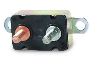

Just for anyone looking/curious, here is an example of an auto-reset breaker that you can insert in place of a fuse:
https://a.co/d/b9mLZ6b
You have to pick the fuse base that matches your panel, but they are available in the common bases.

Mount self-resetting breakers as close to the power end of the wire as practical. I have two in my truck, both just inches from the power lug on the stomp starter switch.
Bill what size breaker are you using? What would you recommend for a 12v system?

I have two breakers. A 20 amp breaker feeds power to my relay controlled headlights. The rest of my home-made fuse/relay panel gets it power through a 50 amp breaker. Overkill, but who knows what you might want to add.
Both breakers are mounted near the starter and get their power from the battery cable lug on the stomp starter switch. They look like this.
