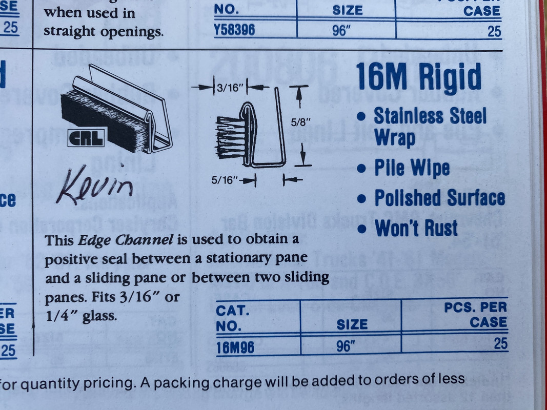

Hey guys just wanted to report back, my glass guy found these which appear to be near an OEM replacement. [img]https://i.postimg.cc/hGF6FQQK/33-B35-B07-FBEE-430-E-8-D71-5-EA094-B7-DBB4.jpg[/img]

It seems you may have to buy a case of 25 96" long pieces.

I contacted them and they do sell individual 96” sticks for $84 each plus a $30 shipping fee(to Michigan in my case) but I found a supplier online that gets a 96” stick to me for just shy of $80 delivered.

That info will be very useful to others on Stovebolt now and in the future. Very good follow up Swizcore.

Just to be as comprehensive as possible, here is the link to the product page I mentioned before in my pricing description.
https://www.defender.com/product.jsp?id=4483343
