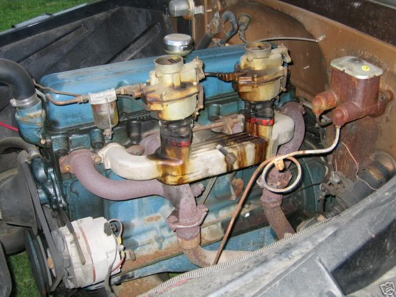

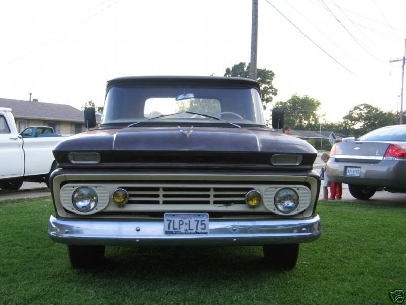

these are some pics of the truck
Dual Carbs
Side
Front

It looks like theres some serious leaking going on with those carbs. Maybe a rebuild would help? Or a float adjustment.

I'm pretty sure that's a 235. If it were a '62 261, it would have big 1/2" NPT oil hoses going out from behind those exhaust manifolds to a big oil filter, and it would have been painted green. However, check the casting numbers to be sure.

That looks like a pretty straight truck, for the age. I've got a 61 fleetside and it looks about the same , color and all. Of course the front grille and hood are different. I know on my 235 on the passenger side, the pushrod cover is one large cover. I believe the 216 has 2 separare covers, but not for sure. Casting #'s would take the geusswork out of it.

Now that I've seen a pic, I'm inclined to agree about a posible float/carb overhaul problem. I also notice the hose coming off the port on the manifold plugged with a screw(?). That could be a potential vacuum leak. Nothing major. Just needs a little TLC.

Well, that leak was the first thing I attended to... the 1/8" NPT fitting going into the carb as loose.. It seems the timing was my problem. it was too far advanced, as i noticed some pre-ignition knock when i loaded the engine down... backed the timing down a little, and she's doing pretty good now! the Blocked off vacuum hose has been removed and replaced with a pipe plug. Hopefully, I'm gonna get some glasspacks installed this week,, it already has duals, but it's got some el-cheapo super turbo mufflers poorly welded on, and it sounds like poo. Also need to change the waterpump, because it has a little slack in the bearings.

The valve cover is from a 59-62 passenger car but it could have been placed on any 54-62 235/261. The 54-62 side cover (push-rod cover) on 235s/261s did not extend over the spark plugs or above the block (it also did not extend above the block on 50-53 235s but yours is not an older 235).
As stated by 4ontheFloor, a 58-62 261 would have 1/2" NPT holes for an oil filter. Can you get us a clearer/closer picture of the oil line holes at the lower right of the manifold side of the block?
The engine color is not a good indicator because many people re-painted 216/235/261 engines that passenger-car blue color (most 261 were green but some were yellow).
Those Rochester carbs (which I like for originality) are jokingly called "leak-chesters" because they commonly leaked at the top-to-bottom joint. There are other things that can cause leaks - it looks like your might also have worn holes where the throttle valve pivots in the body.

Speaking of fuel pumps....I along with others have worked on solutions to the "leaking Rochesters" issue. Some of us have "jumped ship" and gone with Carter/Weber progressive 2 bbls. on our dual setups and some (the faithful) have stayed with their original equipment. One common thread that I've noted is that regardless of the type carb you're running, the addition of a fuel pressure regulator and a mini pressure gauge (from your local auto parts store) that adjusts the stock GM pump down to 3.5 psi cures the fuel dumping problem. No, it's not going to make a dirty carb in need of cleaning and a kit stop leaking, but it will improve your chances of salvaging the original equipment and driving with an engine that idles and accelerates without hesitation.

It also appears that your intake is not heated. It is debatable here, but many including myself will agree that that it is essential for smooth consistent idle and better mileage as well. It's not AS important in warmer climates, but important nonetheless.
I have fentons, and my stock intake (as well as my future 2x1 intake) is water heated. Do a search on intake heat and you will find a lot of info. Good luck and Cheers! Matt
