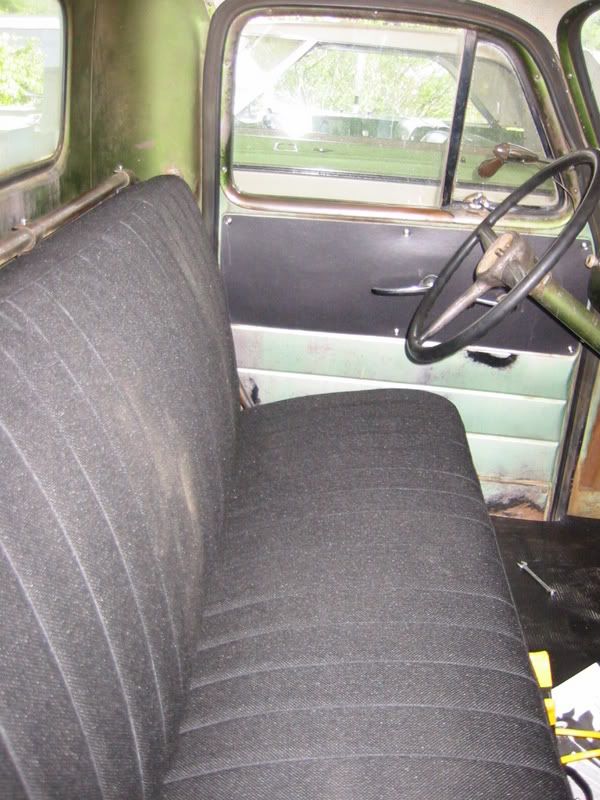

a few pic of the progress...
I got the seat upholstered...
and you can see the stance... the wheel tucks nice... It's got a set of jack stands under the axle..
