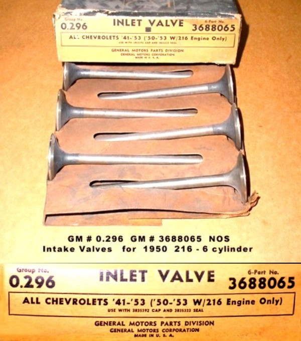

I'd be very leery of the quality of aftermarket valves .
IMO most of the stuff being sold is made in china junk .
My choice would be GM NOS parts for your valve job .
These parts can still be purchased NOS .
You can go to ebay & type in the part # in the search box .
Intake Valves - GM part # 3688760
I see GM NOS inlet valves on ebay .

Dan's has ( 15 ) GM NOS intake valves in stock .
PIC
https://i.postimg.cc/HsF27qH1/Intake-Valves-GM-3688065.jpg

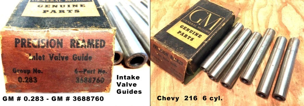

Intake Valve Guides
GM part # 3688760
There are some on ebay
PIC
https://i.postimg.cc/4y9KCF0p/Chev-216-Inlet-Valve-Guides-3688760.jpg

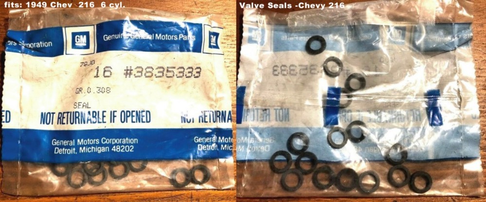

Valve guide Seals
GM # 3835333
There are some nos seals on ebay
PIC
https://i.postimg.cc/HLnQxmPg/Valve-Seals-GM-NOS-3835333.jpg

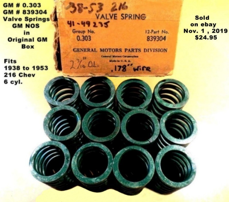

You may want to consider new nos valve springs
They show up on ebay quite often .
PIC
https://i.postimg.cc/wTkJQMCz/Chevy-216-6-Cylinder-Valve-Springs-GM-NOS.jpg
https://i.postimg.cc/Ls74v0gM/839304-216-valve-springs.jpg
