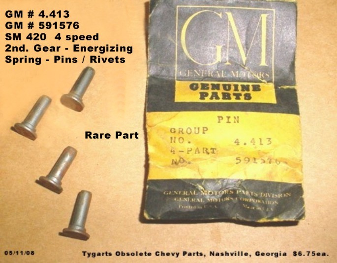

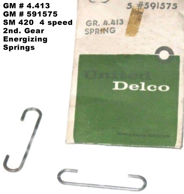

Rather than using the acetal plastic .
I'd just replace the springs with new one's .
PIC
https://i.postimg.cc/bv1krjCW/SM-420-2nd-Gear-SPRINGS.jpg
You'll need ( 4 ) of the Pins / Rivets that secure the Springs
to the actual 2nd. Gear . These are pretty rare parts & are hard to find .
PIC
https://i.postimg.cc/cHZY85PH/2nd-Gear-Pins-Rivets.jpg
Dan's GM Obsolte
Chinook , Montana
phone : 406 - 357 - 2615
Dan's has ( 37 ) energizing springs
He also has ( 3 ) of the Pins / Rivets

George
'54 3600
