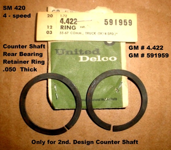

Here's a PIC of the counter shaft Rear Bearing retainer ring .
It's ( .050 " thick ) .
PIC
https://i.postimg.cc/mrW6Fjc8/GM-591959-Rear-bearing-retainer-ring.jpg
It's available GM NOS
Dan's GM Obsolete
Chinook , Montana
phone : 406 - 357 - 2615
Dan's has (14 ) GM # 591959 in stock
Friesen Chevrolet
Sutton , Nebraska
phone : 402 - 773 - 5538
Friesen has ( 14 ) GM # 591959 in stock
UPDATE : 9/21/2019
There are ( 2 ) Rear Bearing Retainers on ebay right now
for $8.00 plus shipping .
Go to ebay & in the search box type in the part # .
