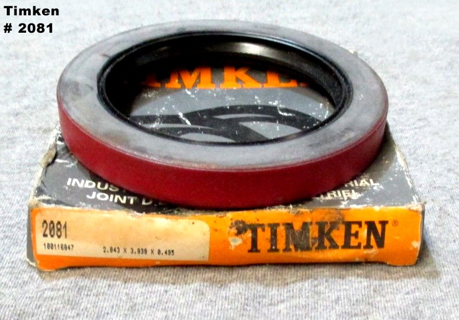

Hy Joel1948, welcome, I come up with National 2081, hope that helps.
That's the same one I show. It fits practically all 3/4 & I ton GM trucks plum into the 90's. Any parts store should have it.

The 2081 seals are also on ebay. I just got two awile back and cheper than anywhere local.

Meanwhile, I'm going through boxes and drawers after not working on my truck for 10+ years and ran across a seal in a box and it is a 2081. No doubt it's for my truck! Why I have one and not two or maybe I replaced one and not the other? and if so which one? I better buy another and replace both. Thanks again for your help.
