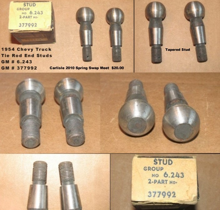

Then you'll need ( 2 ) new NOS Studs GM # 377992 .
PIC
https://i.postimg.cc/fy0NzRPL/Tie-Rod-End-Studs-GM-NOS.jpg

Dan's has ( 1 ) GM NOS stud in stock .
Friesen Chevrolet
Sutton , Nebraska
phone - 402 - 773 - 5538
Friesen has ( 1 ) GM NOS stud in stock
Go to ebay & in the search box......type in the part #......377992
There's a couple of studs on ebay .

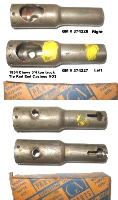

Then you'll need the tie rod shell / body casings
RIGHT - GM # 374226
LEFT - GM # 374227
PIC
https://i.postimg.cc/g0Kp00Kc/Tie-Rod-End-Casings-PAIR.jpg

Shirns has ( 1 ) 374226 - Right
Shirns has ( 1 ) 374227 - Left

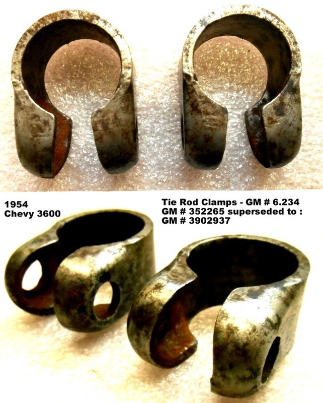

Be very careful when removing the tie rod end clamps .
They are scarcer then hen's teeth .
Do not destroy the clamps . You can save the old clamps & clean them up
and repaint them and replace the nut & bolt with grade 8 .
Clamps that I bought years ago
PIC
https://i.postimg.cc/W4bt20w1/1954-3600-Tie-Rod-end-Clamps-GM-352265-superseded-to-3902937-b.jpg
