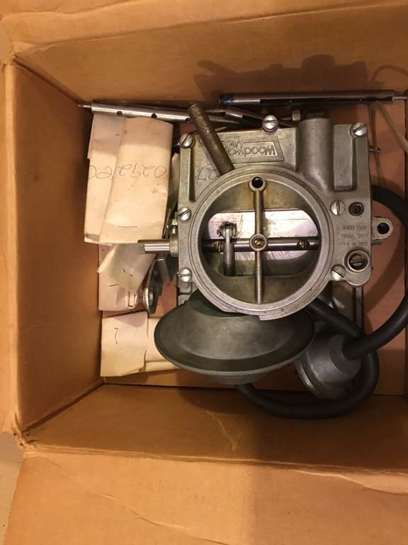

Long before the Predator (actually, about WWII), there was the Woodworth. Below are a couple of pictures of the very first Woodworth that was placed on a car for testing, and subsequently removed. This unit came from the Stromberg Engineering Department from a group of unusual carburetors.
After the Woodworth failed, there was the Kendig, and sometime after it failed, the Predator emerged.

The Woodworth was smaller than the Predator, and was attempted to be sold to replace the late 1940's two-barrels.
Back to the Predators: the only group (there may be a few individuals) that seemed to use the Predator successfully were the monster truck folks on monster engines with blowers. My guess would be the design kept a more constant flow of fuel through the different angles. Did you ever watch the antics of those monster truck drivers?
