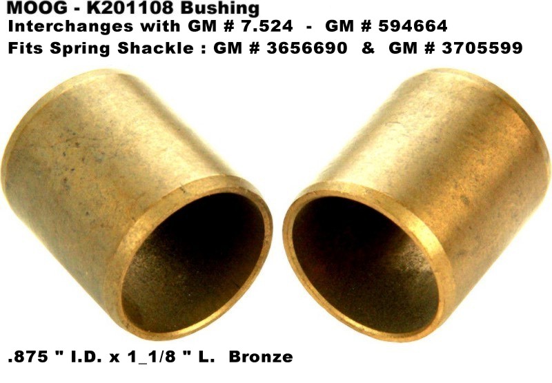

These bushings made by MOOG
are excellent replacements .
PIC
https://i.postimg.cc/ZqrL0rhG/594664-moog-2.jpg
