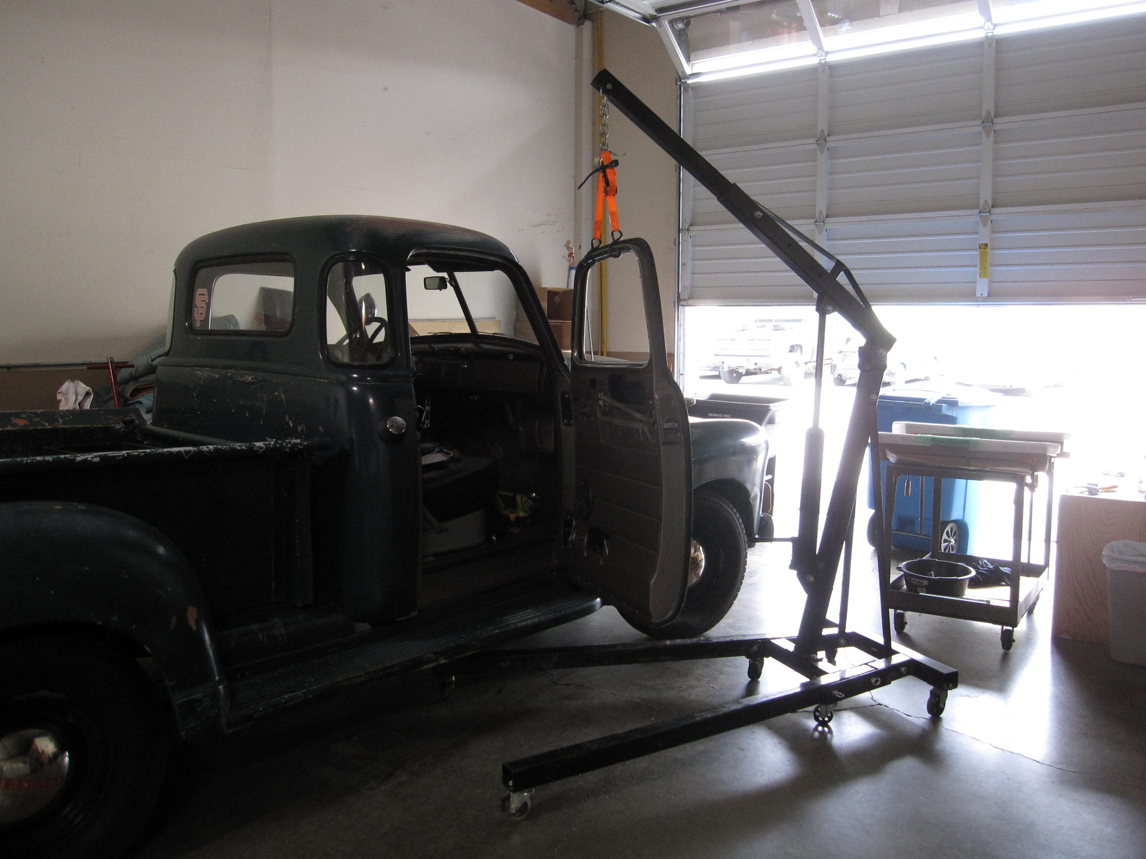

I believe Chevy and GMC doors are the same, but hopefully an expert in this area will chime in to confirm. Do you have access to an engine hoist? I have remove both of my doors to install new weather stripping by using an engine hoist. I lower the window down and run a couple large nylon straps thru the window opening and up to the engine lift's hook. I'm sure there are other ways and hopefully will jump in and give you more details.
Here's a pic of my door dolly:
[img]http://www.cmaynard.com/Truck/TruckDoorDollyB.JPG[/img]
Craig

The engine hoist and strap idea is genius. It would hold the weight of the door and let you pull it straight away from the body, not having to worry about it getting away from you.

That would work too, but you can't let go of the door completely with it partly detached from the hinges. Hanging the door from the top would let you never worry about it crashing to the ground. Height is infinitely adjustable as well with the engine hoist.
