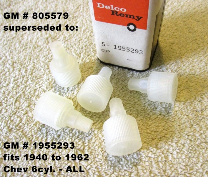

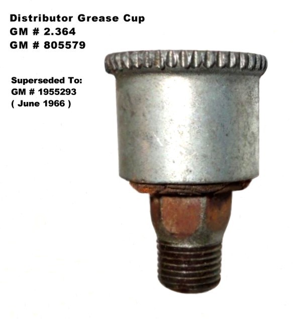

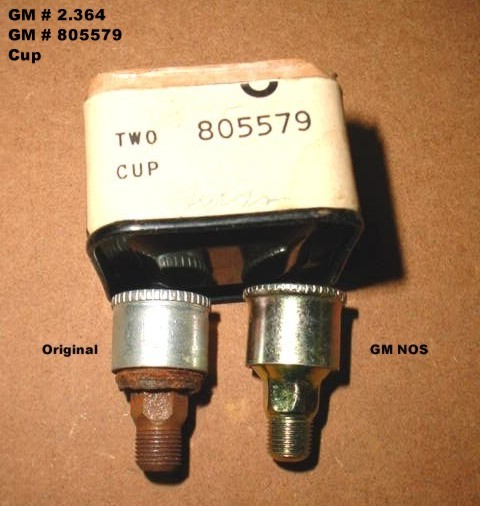

The distributor grease cup is often a very neglected service operation .
Some don't even know what it is , your distributor will reward you with
longer life if you perform the needed service it requires .
Grease Cup PIC
https://i.postimg.cc/507hHsFn/Dist-Grease-Cup-Spring-Plug.jpg
https://i.postimg.cc/wv71ywxd/Distributor-Grease-Cup-GM-805579-2.jpg
https://i.postimg.cc/2yn8hJPg/Grease-Cup-1955293-GM-NOS-Old-GM-number-805579.jpg
https://i.postimg.cc/tT5BJCgc/805579-Dist-CUP-GM-NOS-3.jpg
GM # 805579 - Grease Cup GM NOS - is available
Collector's Auto
Blaine , WA.
phone: 800 - 414 - 4462
Collectors Auto has ( 4 ) GM # 805579 in stock .
Llewellyn Obsolete
Northridge , CA.
phone: 818 - 363 - 5094
Llewellyn has ( 1 ) GM # 805579 in stock

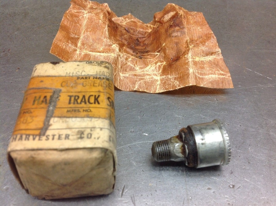

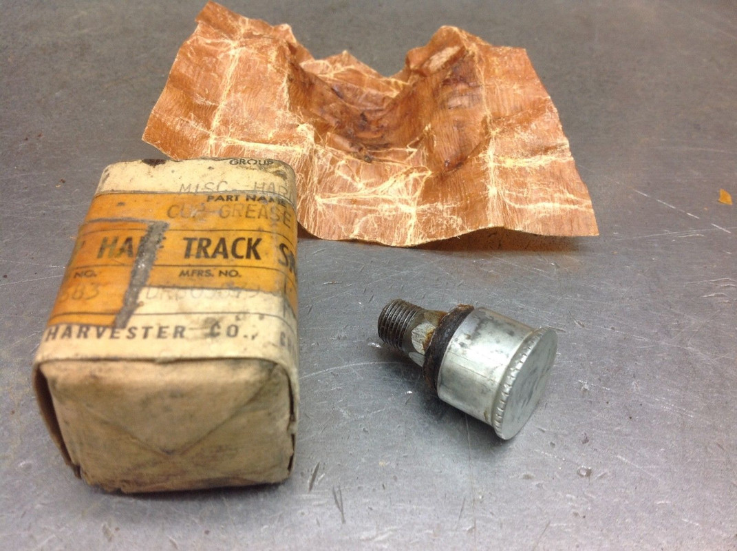

There's a NOS GM grease cup # 805579 for sale on ebay @ $4.50 plus shipping
PIC.................. https://i.postimg.cc/QxtjXFMR/grease-cup-b.jpg
PIC................. https://i.postimg.cc/gJmP1J5t/grease-cup.jpg
Go to ebay & in the search box..........type.........HALF TRACK DELCO REMY GREASE CUP

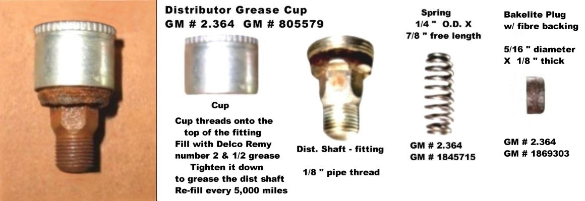

Unscrew the cap & clean out the old caked & baked grease out of the cap
Refill with fresh grease .
Check to see if the spring & plug are still there
If the spring & plug are there ,
You can remove the spring & plug and clean out
that area of the grease cup .
Clean the spring & plug & put them back into the fitting.
Tighten the cap until the fresh grease starts to come out of the end of the fitting .
Re-install the grease cup into the distributor .
After installing , screw the cap down one turn so grease gets to the shaft bushing .
Tighten the cap down every 1,000 miles .
Re-fill cap every 5,000 miles .

It is worth your while to check and see if the spring and Bakelite disc are in place. They keep pressure on the shaft to keep the shaft from wobbling. If the disc is missing, the spring is riding directly on the shaft cutting into the shaft it self. Clean out the old grease, repack and as recommended above, a turn Every once in a while. New Bakelite discs are near impossible to find. The piece to the right is a piece of Delrin that I cut down to use as a replacement.
