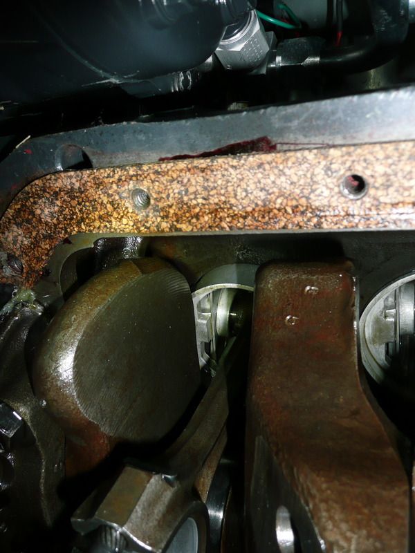

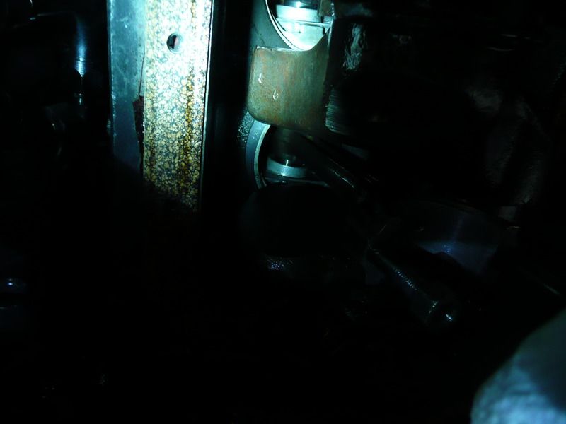

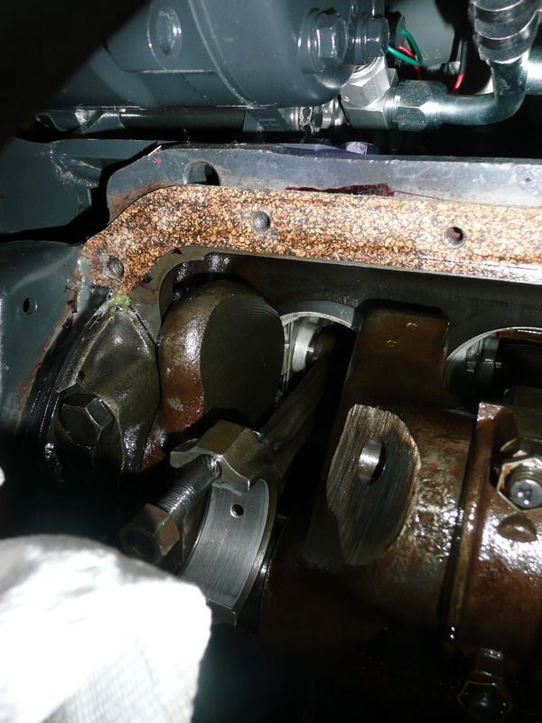

I took a couple of photos this morning. Looks like a crack on the piston surrounding the forward part of the wrist pin. I don't know how to get more than one click of magnification with PhotoBucket but hopefully it is good enough. I don't see anything on any of the other pistons.
Pic1
Pic2
Pic3

Getting past all the popup ads on Photo-BS is frustrating. It doesn't look like you're able to get enough detail in the pictures to be of much help, but there's a work-around on the zoom. Hold the "control" button down on your keyboard and repeatedly push the (+) button on the top row of keys. Shrink it by hitting(-).
