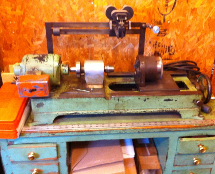

Of course, in 1929, Carter engineering had to have a method of producing prototype metering rods; thus a custom lathe was hand-built for this purpose:
http://www.thecarburetorshop.com/Lathe_1.jpg
Specifications for the lathe included:
(A) a motor turning 3450 RPM instead of the normal 1725

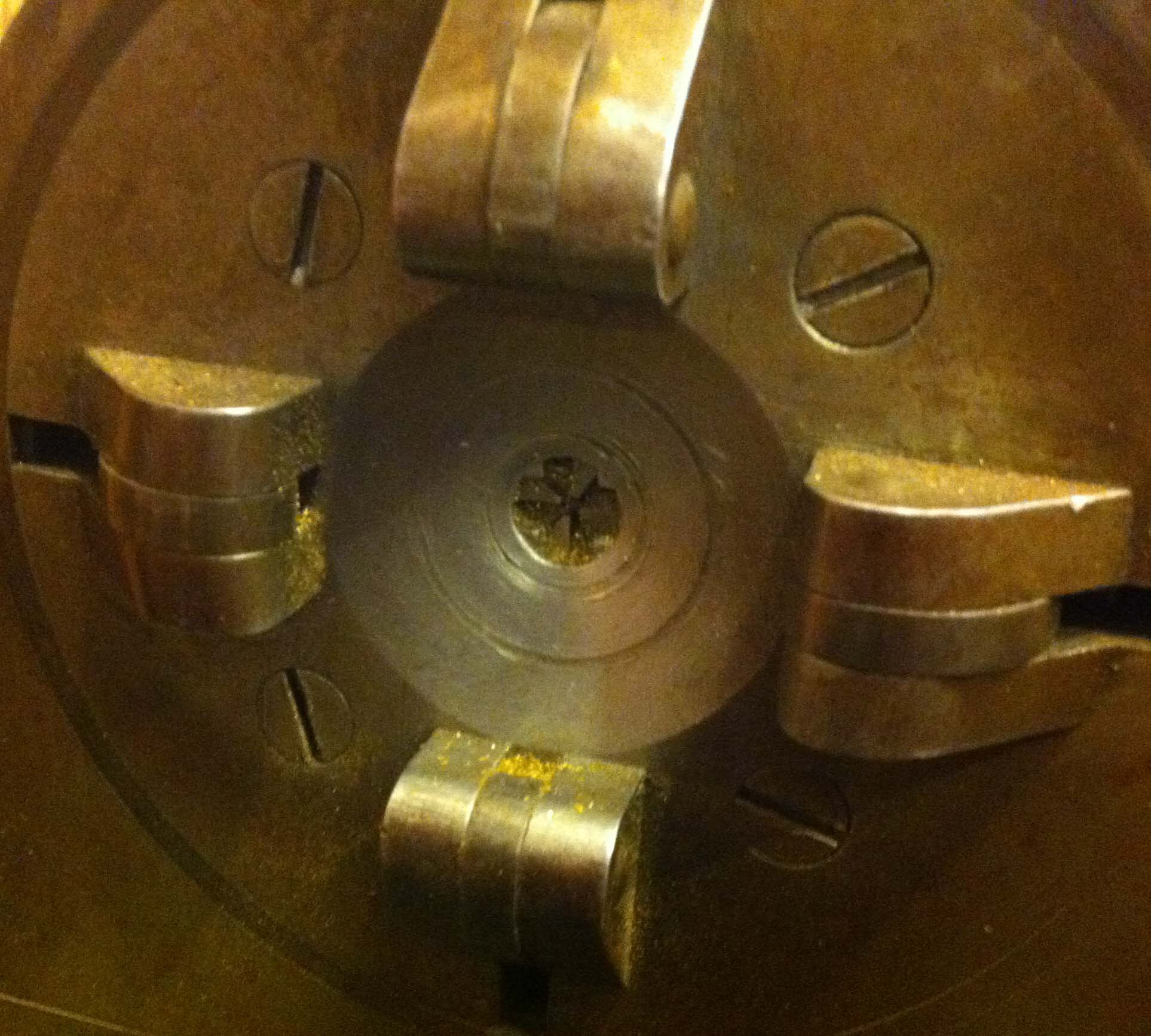

(B) a special cutting head mounted in the tailstock that slides over the stock, with 4 cutting tools equally spaced at 90 degrees from each other thereby preventing excessive deflection of the small round stock:
http://www.thecarburetorshop.com/Lathe_3.jpg

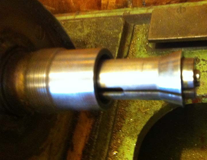

(C) a special headstock accepting collets to hold the round brass stock:
http://www.thecarburetorshop.com/Lathe_4.jpg

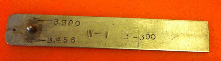

And jigs were necessary to check the diameter and spacing of the pigtail, and the length of the rod. The picture below is the jig for the W-1 rod. Each carburetor style used different rods, some even used rods of different lengths:
http://www.thecarburetorshop.com/Lathe_5.jpg
The sizes of the rods were specified to the ten-thousanth of an inch so all of the above were necessary to keep the tolerances within range.

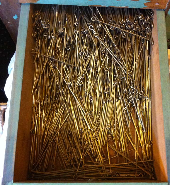

For some reason I never learned, several different rod diameters were used. Below is a picture of 0.072 rod stock:
http://www.thecarburetorshop.com/Lathe_2.jpg
Since the total calibration at any given engine condition is the diameter of the jet less the diameter of the step of the rod currently in the jet; simply changing the jet(s) MAY allow for a precise change at one engine condition, this will virtually always throw off the calibration at other conditions. Example: someone that NEVER operates the engine at wide-open-throttle may install a smaller jet to improve cruise economy, but runs the risk of the engine going very lean at WOT.
Rods, depending on the style of the carburetor, were produced in 2 step, 3 step and 4 step calibrations. Most were tapered between steps (try cutting a taper from 0.0455 to 0.05025 on a manual lathe).
