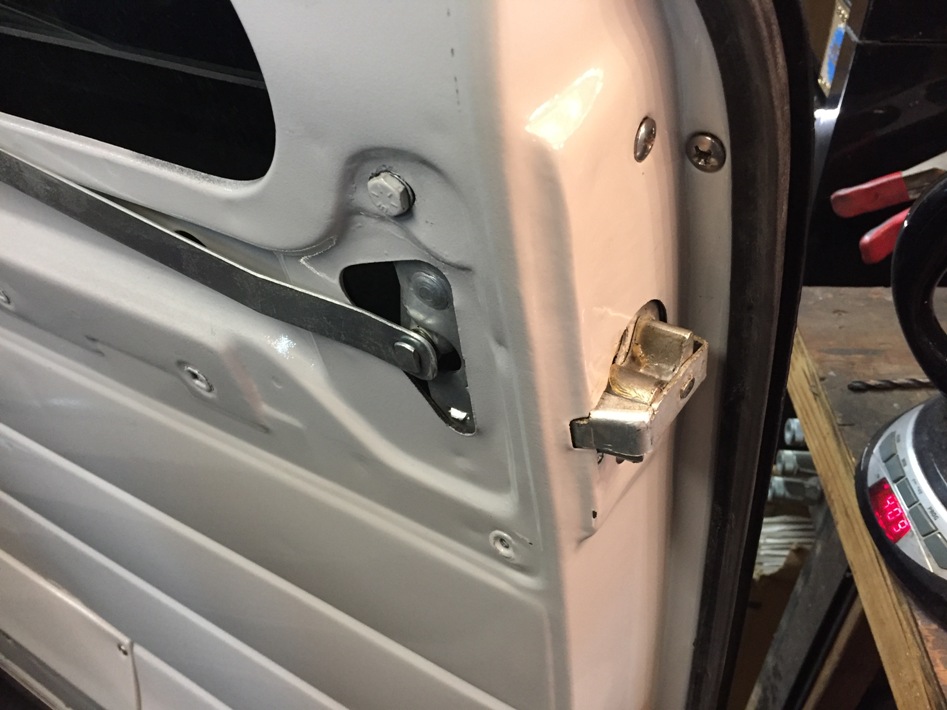

Turn down handle, remove outer screw when visible. Open door, peel back weather strip, remove inner screw. Pull straight away from door. Could be a little sticky as the metal rod wears inside the latch. Sometimes loosening the latch will help with that.
Posts: 4,254
Posts: 4,254
I'm sorry. You don't have to peel rubber to get that inner screw.
http://www.bunchobikes.com/1952suburban239.JPG
