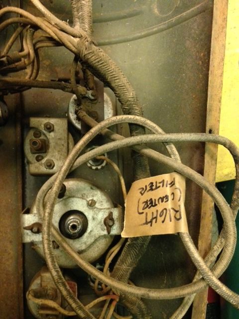

I think I can cover this one. Here is a pic of the ammeter etc. http://i1293.photobucket.com/albums/b585/Milibolt/Electrical%20systems/IMG_1612_zpswdx5gppt.jpg from the dash of my spare cab. It apparently has the original harness and while somewhat brittle, is quite complete. The wire you see coiled up and marked "filter rt. side" or similar is the wire you are referring to. I marked it and perhaps it was connected to the filter when I got it, but it's over 4 feet long and has a 3/8 inch ring which I would think surely would connect to the starter (bat) lug which is shown on our schematic for these rigs.
It's a fatty. I measured it with my venereal calipers as follows. .270 around the insulation, .145 around the conductor itself (I didn't want to peel off more insulation so I measured it in a small area near the ring connector. The ring as mentioned before is 3/8 in.
Hope that sheds some light on that one question anyway.

Tony, I need a little help here if you don't mind. Why does that big 'old wire run from the ampmeter to a filter? He said it was military and they do strange things, I know as I spent 20 years doing them. Thanks
Joined: Feb 2013
Posts: 111
Joined: Feb 2013
Posts: 111
Sure. It's all about "radio suppression". In the manual I have it speaks of the "early production system" where there were 7 suppressors, 6 filters, two condensers. Suppressors were used on all the high tension spark plug leads and also from the dist. to the coil. Of the filters, 4 were used in the generator circuit and 2 in the ignition circuit.
I had marked that wire when I removed the dashboard and I noted that it came off of the ignition coil filter. But that defies the electrical schematic, so I'm not totally sure why it was connected there. It might have just been holding the wire, because when I bought the "1942 Chevy Cab", it was just that. No frame, starter, etc.
BTW, the "hot" that comes from the generator to the ammeter goes through the (no surprise) ammeter filter.

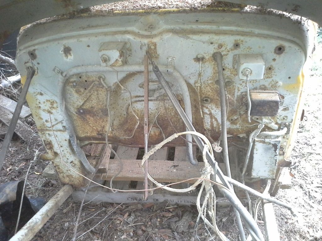

Here is a picture of the firewall of my spare cab. http://i1293.photobucket.com/albums...0systems/20140403_181036_zpslckzy0ry.jpg
The ammeter filter (just above the VR) and the ignition filter (like the ammeter filter but left of center on firewall) can be seen. Also, this picture clearly shows (to me) that I must have made a mistake marking the wire that Paul was asking about. The wire from the ammeter to the area of what would be the starter motor is quite apparent.
