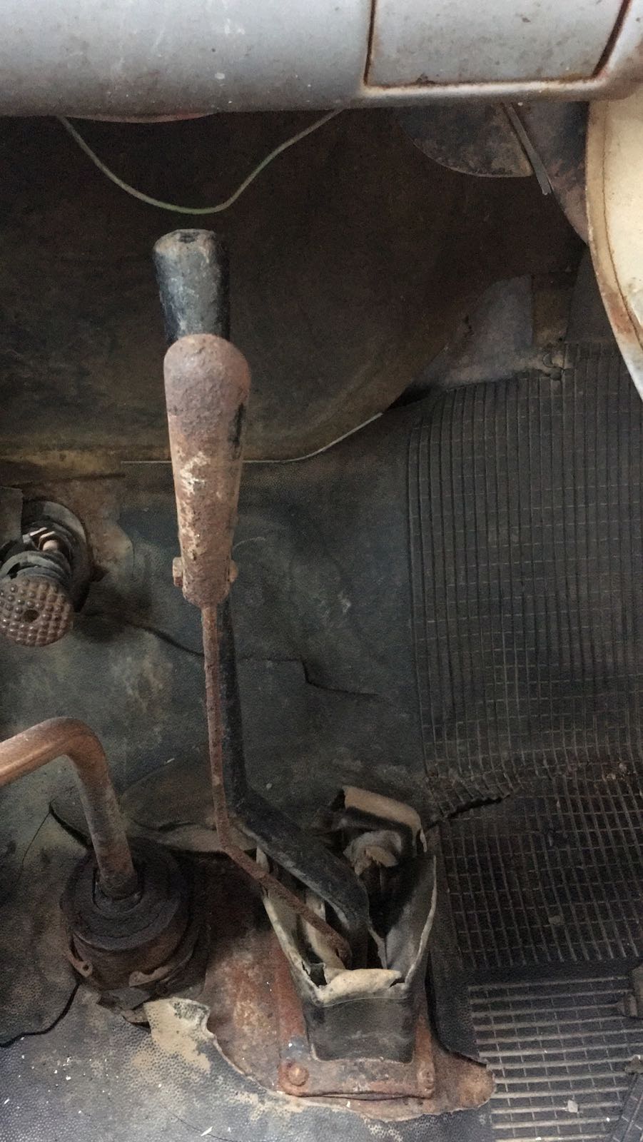

I am confused at a 1958 Chevy 3600 that I was researching for fun that has this extra shifter on the floorboard near the tranny shifter which I assume is the 4 speed with granny gear. Does anyone recognize this? Is this factory?
Thanks.
Please identify this shifter. Is this 4wd or something else?

Is it the emergency brake?

2 shifters for an emergency brake? Haven't seen this before.
No. One shifter, one parking brake handle.

Ok, looks like 2 shifters on the right. Did all 3600s have this? Don't see them in all of the photos. Cool.

Pull the handle towards the seat and you will hear a clicking sound as the lever moves. It will get hard to pull and when you let loose of the handle it will stay in place. Squeeze the little handle as you apply pull to the rear then hold the squeeze as you release the lever forward.
Looks just like the one I had on my 4100.

Going back to the original question, yes, it is factory. TF 3600's came standard with three on the tree with the parking brake lever under the dash to the left of the steering wheel that actuated the rear brakes. 3600's with 4 speeds came with the floor mounted prop shaft brake. This differs from the 3100's and 3200's that were ordered with the 4 speed because they retained the same parking brake as the three on the tree.
