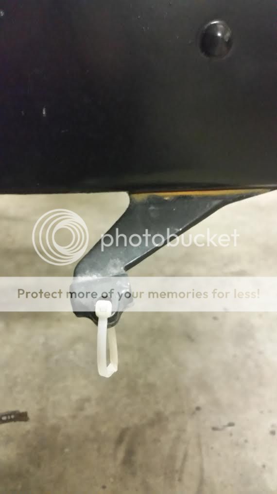

New members here trying to put back together a truck we didn't take a part wink
We believe this to be the original parking brake bracket to hold the cable at the frame end?

If we are correct, we are planning on removing all of this and installing a line lock to replace the parking brake, any reason I shouldn't do this that anyone can think of?

1) Yes, that is the bracket that holds the cable to the frame.

Thank you VERY much!
OK, so all of that will be removed before the cab goes back on.
Line Lock is a "hydraulic" lock for the brakes that goes in the rear brake lines traditionally.
