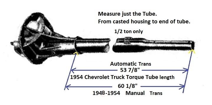

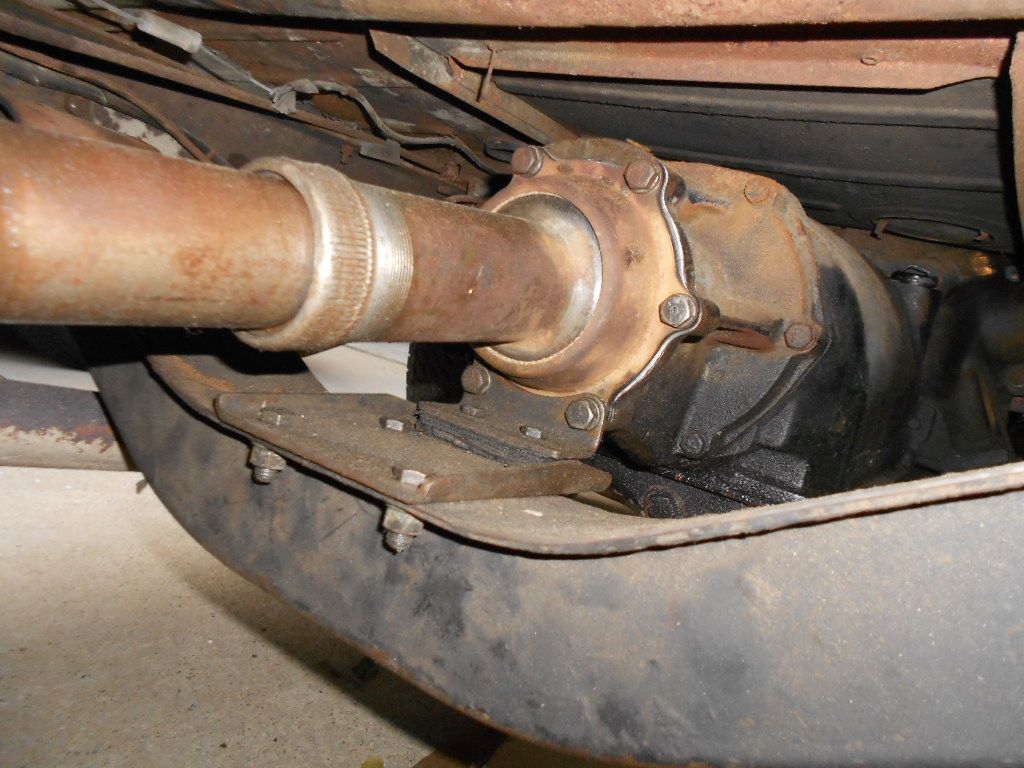

The Hydra-Matic transmission needed an additional crossmember and rear mount, but the 3-speed and much heavier S420 4-speed no longer needed a rear transmission mount/cross-member.
The Hydramatic transmission length is 8" inches longer and its torque tube is 8" inches shorter.
More weight is hanging farther out pass the flywheel housing.
Hence the need for the a rear transmissions tail housing cross-member. Picture: 1954 Chevrolet 1/2 ton H-M rear tail housing crossmember
The re-engineering of the cross-member under the flywheel housing in 1954 eliminated the need
for a rear transmissions tail housing cross-member on the 3 and 4 speed transmissions. Picture: 1954 Chevrolet 1/2 ton rear of 4 speed trans.
Both 3 and 4 speed transmission are the same length so are the length of their torque tubes. TT Measurements

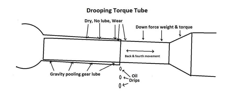

There was a company that made some kind of support Picture 1 , Picture 2, Picture 3, Picture 4
that clamped around the tail of the U-Joint ball housing and the torque tube.
Its soul purpose was to prevent the torque tube from drooping downward.
The reason for the torque tube droop is probably coming from the downward force when applying the brakes. Picture 5

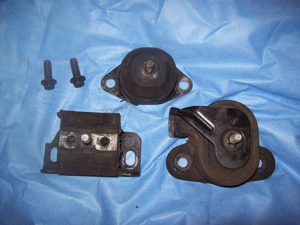

I am reading the comments posted but staying out of the argument. However, here is some more info for thought.
The original S10 T5 tail rubber support is shown HERE (center of picture).
HERE I am holding it.
The threaded end goes into the S10 crossmember and the 2 holes on the plate end bolt to the bottom of the S10 tail housing.
The bushing seems to be designed to allow some torsion (either from the frame twisting or from the drivetrain torque. A single bolt is molded into the rubber. The design would allow the rubber to rock a little side to side.
I'm not arguing FOR or AGAINST a cross member. Just supplying a little info, that's all.
If you are convinced that a cross member is what you want, then by all means use a rubber mount like in the photo.
THIS ARTICLE printed in Hot Rod Magazine in 2012 shows a cross member support that in my opinion is engineered COMPLETELY WRONG. See photos #23 and #24. They have the tail housing bolted to a 2 bolt style rubber bushing which will not allow sufficient movement with torsional forces applied. A single bolt design that is molded into the rubber (like the one from my photobucket page) would allow movement and yet add support.
