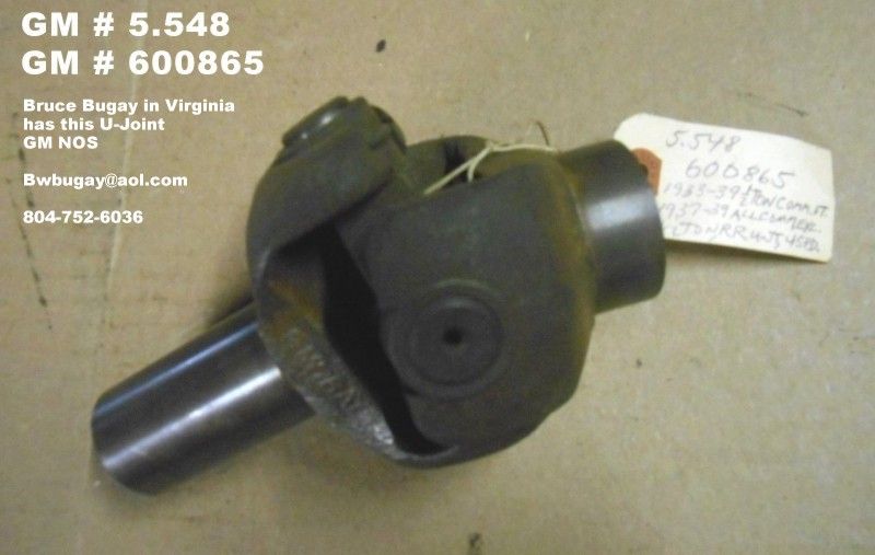

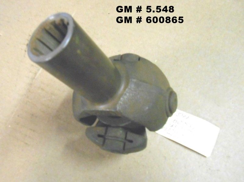

Bruce Bugay in Virginia has the U-Joint you need.
$99.00 plus shipping
GM NOS
GM # 5.584
GM # 600865
photos@photobucket with contact info
http://i669.photobucket.com/albums/vv57/glp0329/GM%20600865/GM_600865_b_zpsgempd3lm.jpg
http://i669.photobucket.com/albums/vv57/glp0329/GM%20600865/GM_600865_zpshgdeyuwr.jpg
George
