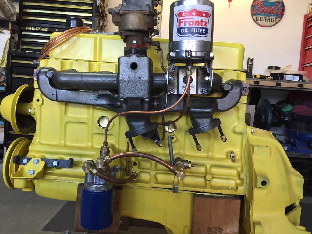

Resurrecting an old post just to show a picture of the final plumbing of the dual full flow and bypass filters on the 261 that I'm almost done with.
Per HRL's recommendation, I decided to use a Frantz toilet paper filter for the bypass instead of the AC canister. I got lucky and found one in the scrap pile of a salvage yard. I mounted it on the rear of the intake manifold to leave more room for my AC compressor which is mounted high on the same side. The plug in the gauge hole is temporary.
Everything fit fine even with the dual exhaust manifold.
http://s844.photobucket.com/user/ma...359_zpsbjeoqwg4.jpg.html?sort=2&o=10

Fox #1198935 01/08/2017 8:21 PM
Looks real nice, Matt
Nice dual exhaust manifold, too.
Was your 261 originally yellow, or did you prefer to use that 261 yellow color? It looks good.

That's a lot of filtration! Nice. I've heard all kinds of crazy stories about the Frantz filters extending oil change times.

Tim, it was originally yellow. The engine came from a '57 6400 cement truck. Everything but the block had the original yellow paint under several layers of Chevy orange. The block was replaced at some point in its life. It has a 1964 build date and no serial number. From the research I did, '57 was the one year the 261's were painted yellow. Since it started life yellow in a '57, and since it is going into a '57, I painted it yellow.
Thanks for the comment about the manifold. I got the ideal from this site--
http://www.restorodstogo.com/2011/01/235-261-chevrolet-split-dual-exhaust.html
HRL helped me with advice on welding cast iron and how to split the cylinder banks by milling a slot through the back side, then fitting and welding in a plug.
Matt

Matt, thanks for posting those pics- I'm going to be starting on the plumbing for my 261 very soon and this is exactly how I want to do it... The PO of my truck had rebuilt the motor only 10k ago, but when I tore it down it had evidence of oil starvation at the rocker shafts and at the cam bearings. It's a full flow motor but someone had plumbed the filter with tiny bypass lines. I'm going to make sure it's done right this time.
How in the world did you replicate that exhaust manifold? It is beautiful...I don't understand how the second outlet was fabricated- can you elaborate?

The engine is going into my '57 3600.
The manifold is made from two manifolds, a good one and a donor. It's a shadetree mechanic's way to replicate the '53-'54 Corvette manifold. The good manifold has a 1/4" slot cut into the back ahead of the #4 cylinder. A plug is carved with a die grinder to fit inside the slot to block off the front cylinder bank from the back bank. The plug is welded into place when the slot is welded shut.
The exhaust dump off the donor manifold is cut off using an angle grinder. The heat flapper box is cut off at an angle. Fabricate a piece and weld it to the exhaust dump where the heat flapper box was cut at an angle. The exhaust dump is then is carefully ground and shaped to fit over the 4-5-6 cylinder end of the manifold about where the part number is cast. Once the dump fits correctly, the outline is traced on to the good manifold. Move the lines in 1/4" and cut out the shape. Bevel the edges of the exhaust dump to accept weld, then weld into position.
All of the fabricated parts are made from metal from the donor manifold This avoids mixing metals which can create welding complications and expansion/contraction issues during operation.
Welding cast can be tricky to prevent cracking and warping. I used a #6 rosebud torch to preheat. I mig welded with Crown Alloys Royal 44-30 .35 wire which is a nickel manganese blend designed for cast iron. I welded in short stitches of about 1" and used the pointed end of a slag hammer to relax the weld after each stitch with about a minute of steady, firm tapping. The first pass was for penetration. Additional passes were made to fill. Once finished, the weld was buried in sand overnight to cool slowly. It was ground down after it cooled off.
Here are a few more pix including a couple that I pulled off eBay about a year ago showing the front and back of the Corvette manifold. Note that the Corvette manifold is cast so that they cylinder banks are separated.
http://s844.photobucket.com/user/ma...2040_zpsghebo01x.jpg.html?sort=3&o=2
I bolted the intake and exhaust manifolds together and had the machine shop mill the flanges perfectly flat while they were joined together to get a good seal just in case there was any warping caused by the welding. That cost $35, but it was well worth it.
I went with this design to get the benefit of the split exhaust and still retain the factory heat exchanger system.
Matt

Originally Posted by JW51
What kind of vehicle is the 261 going in? I'm pretty sure in my AD truck that the Frantz in the rear position would have some issues with steering column
Matt's 261 with Frantz filter
1960 standard location of full-flow filter
I do not think that the Frantz filter is located closer to the firewall than the original full-flow oil filter is located?
Once again, that is a beautiful set-up, Matt
Please post a picture when/if you get it in place in your truck.

Thanks Matt. [EDIT] Okay, I see now how you did the manifold.. that is a lot of additional welding compared to doing a simple split- I am amazed that you were able to keep the manifold from cracking. Great work.
I currently have a split manifold, but the added rear flange has only a 1 1/2" ID and I am having trouble believing that it will be worth putting in the truck with such a small diameter outlet. It looks like it was made from one of those exhaust splitting kits that they used have back in the day.

I'm actually in complete agreement. It looks really sharp. I was just trying to picture it in my truck (an AD). I don't think firewall is an issue, but steering column and/or fender brace might be. I'm not as familiar with the clearance issues in a task force or 60s truck.
Without extensive modification by block (a 235) wouldn't have the full flow piece of that system anyway. Speaking of which, will the Frantz work with the "standard" bypass plumbing of a 216/235? As in, would it get the appropriate amount of flow?
