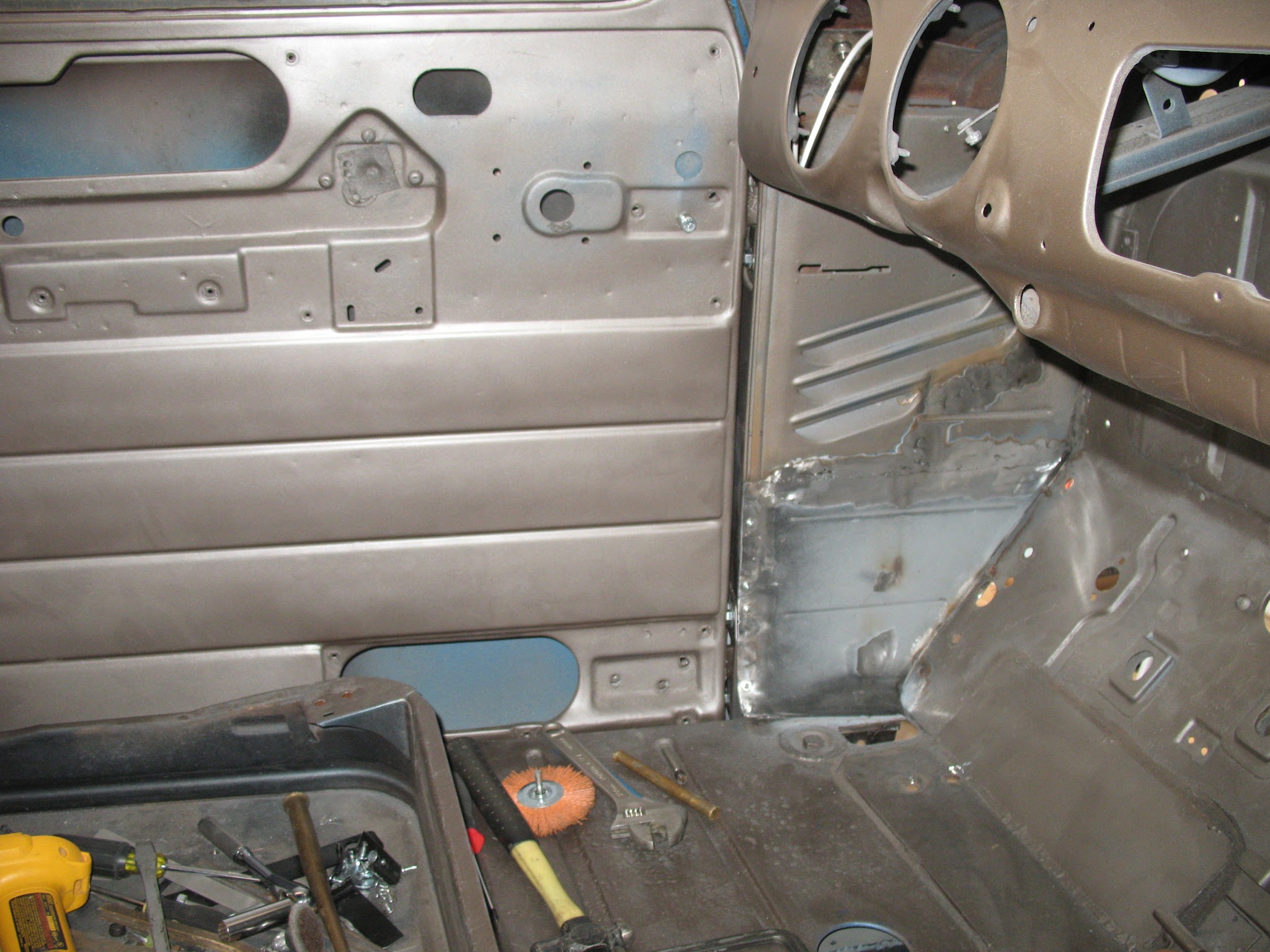

I have embarked on a mission to save a 1953 3100 and replace or repair a lot of the sheet metal. Thought I would share it with you guys. I am always looking forward to ideas on things to do better or different.

looks good
the only thing I would add is on the kick panel.
there are beads that line up with the door
...pic...

At least I hope they do! I did not know that. I put the panel in from the bottom inside out, so they should. I do not have the door on it right now to check. Interesting. Fitment was OKAY, but not ideal. Some of that could be attributed to the tolerances of the cab itself?
