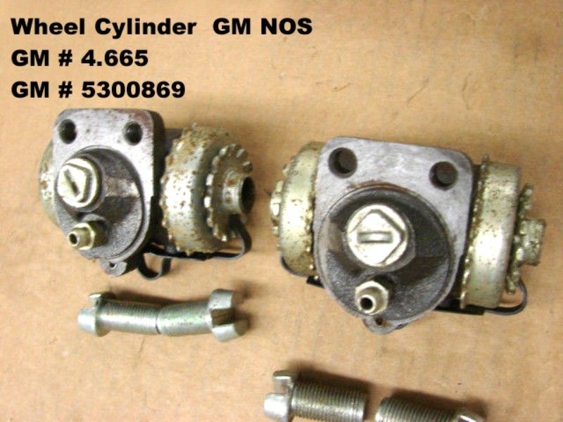

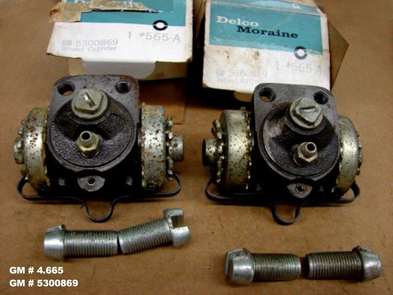

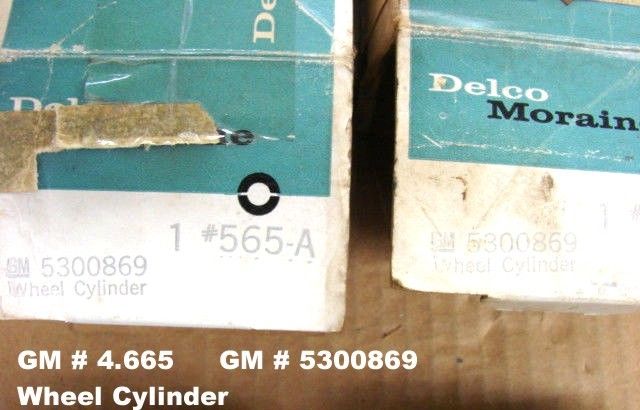

There's a NOS pair of Wheel Cylinders
on ebay right now. Go to ebay and in the search box
type in the part # - 5300869
Seller wants $200.00 or Best Offer
Photos@photobucket
http://i669.photobucket.com/albums/vv57/glp0329/Wheel%20Cylinder%205300869/1abc%202_zpsghecfgbe.jpg
http://i669.photobucket.com/albums/vv57/glp0329/Wheel%20Cylinder%205300869/2abc%202_zps4hd58lls.jpg
http://i669.photobucket.com/albums/vv57/glp0329/Wheel%20Cylinder%205300869/3abc%202_zpsbeyqyyem.jpg
