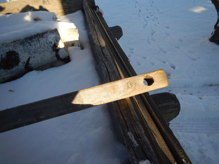

Before I retired, I would crawl under the '48 in the evening and place the heater on the pan. I didn't want to crawl under the truck in the morning dressed for work so I drilled a hole in a 2x2. I could slip it onto the handle, take off the heater with a twist and keep clean.
Magnetic Heater Remover.

PATENT THAT [censored]!
