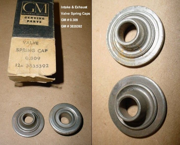

I am assembling a 216 head and I have two different types of caps to hold the springs in place. The picture in the manual shows what looks like one is for intake, one for exhaust. The intakes look to have a slightly raised center section and the exhausts look to be flatter and squared off.
Is this correct ?

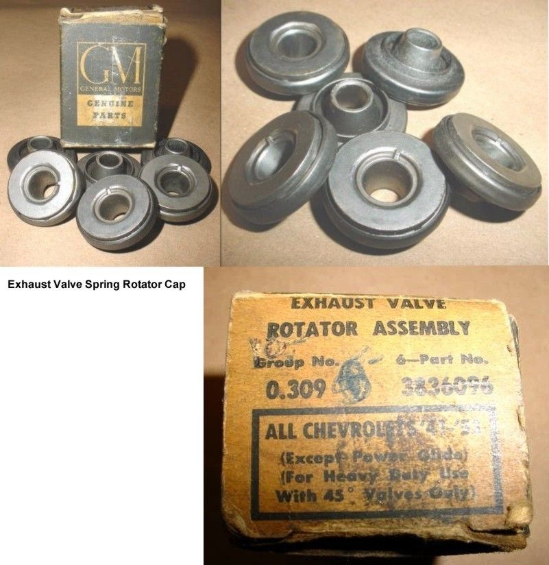

Some engines had rotators on the exhaust valve to keep carbon from building up.

The head is a 52. I just assembled it after studying the pictures in my manual. From the pictures you sent, I got the intakes right so the others had to be right as well. Then I found a set of the rotator caps in my collection os parts. So I may be switching them out and use the rotators.

The rotator caps (used on exhaust valves on some stovebolt engines) were also used with longer springs (and, the caps were thicker than normal caps). This resulted in greater valve spring "pressure". In engines that used the rotator caps, the valve spring "pressure" was significantly greater. The higher spring pressure was used due to the higher lift of the 261 cam (a cam used in 1954/55 Corvette 235s and in all 235s in later years).
This higher spring pressure presumably resulted in better heat transfer (cooling) at the contact surface, and I guess, lower possibility of "valve float" (especially at high RPM). On some engines (maybe not stovebolts?), valve float might result in a valve hitting a piston.
On stovebolts, different composition valves were used with the rotators (Silchrome XCR).
Exhaust valve rotators were first used on heavy-duty stovebolt engines (in 1954, I think); but, by the end of the 235 "run", I think they were used on all 235s & 261s.

Stove bolt engines as well as other Chevy engines used in trucks and heavy industrial applications used rotating valve spring retainers on the exhaust valves to increase the life of the valve. The installed spring height of the valve springs on a stovebolt is the same no mater which retainer is used.
The valve springs listed for all 1962 235&261 engines are the same part # therefore they are the same spring.
Putting thicker i.e. heavier retainers on a performance engine is asking for valve float. In fact the opposite is true. The higher the RPM the less weight you want on top of the valves ergo titanium retainers.
A quick aside, V8 international truck engines used exhaust valve rotators but they were placed under the valve spring. The exhaust springs were shorter than the intake springs to keep the installed height of the springs the same. Hope this helps.
