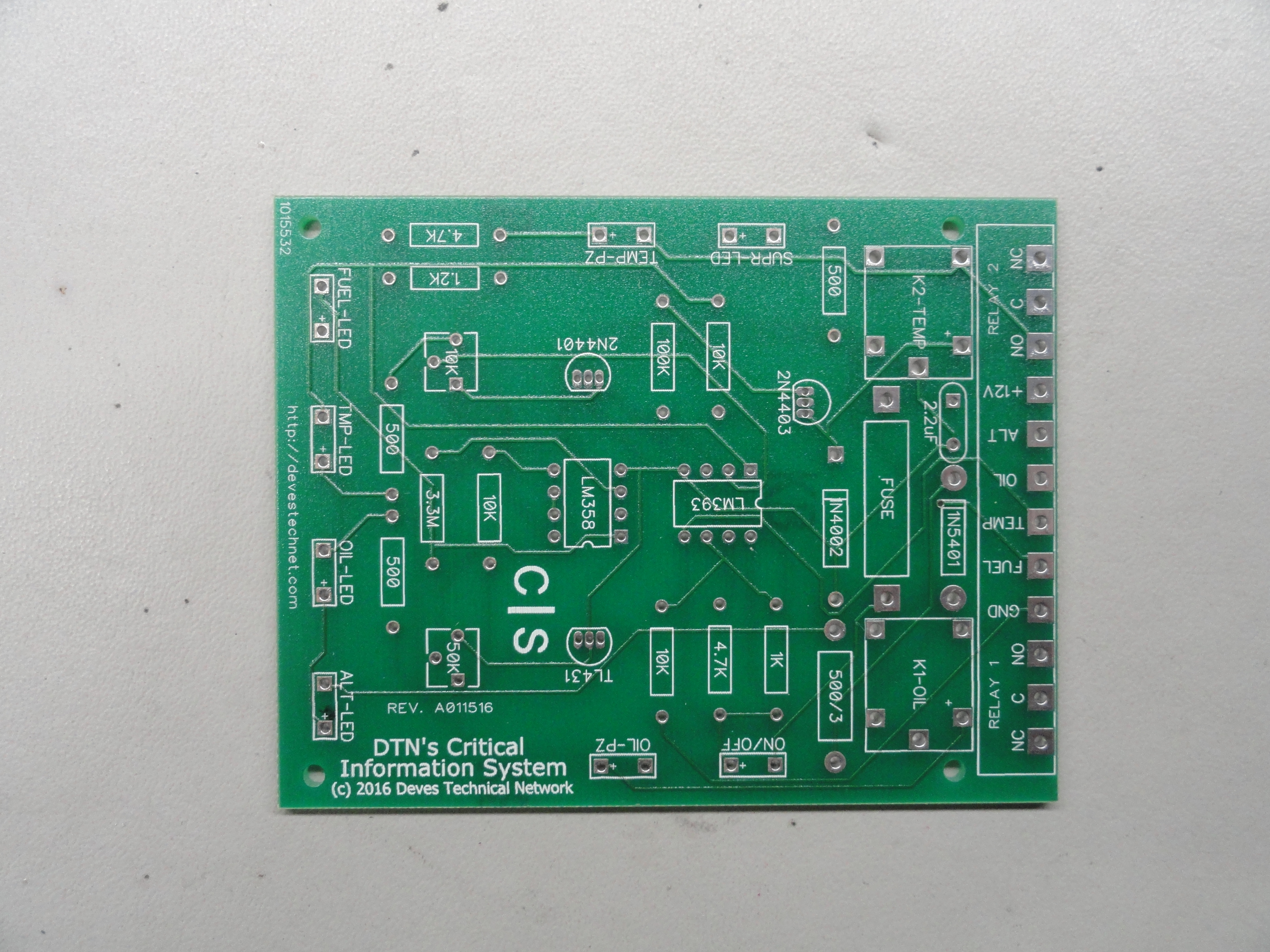

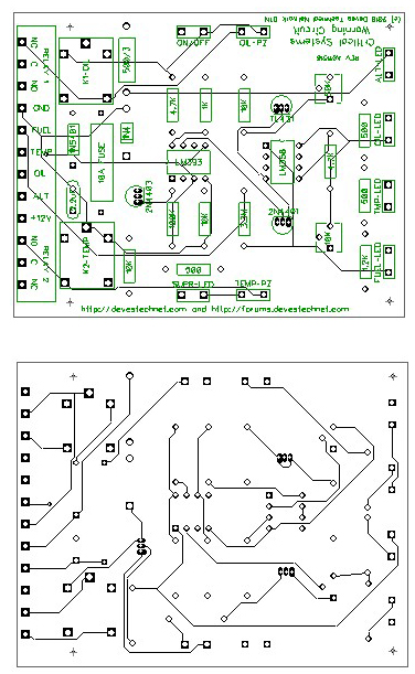

After a few weeks of testing and various setbacks I feel pretty good about the basic circuit. I wanted to make this thing Scaleable. Meaning, if you want an audio alarm on Water Temp, or whatever, or you just want lights, it is all customizable. The document has been started here:
http://devestechnet.com/Home/WarningSystem
But there is a lot I could use help with. You do not have to be an electronics genius to participate. Some of this has to do with placement in the truck, which Heads-Up's are important to you, etc.
Then there are questions I have not resolved like: Concerning the Water Temp Sensor... We can't move what is already there because our vintage gauges need that mechanical signal, so where do we put a second sensor (has to be in water to work)?
Is a fuel gauge (gas tank going empty) something we could use and if so, what can we use for a sensor for that?
I am sure more questions will arise as the discussion develops. Check out the article and let's discuss your ideas here. Thanks!

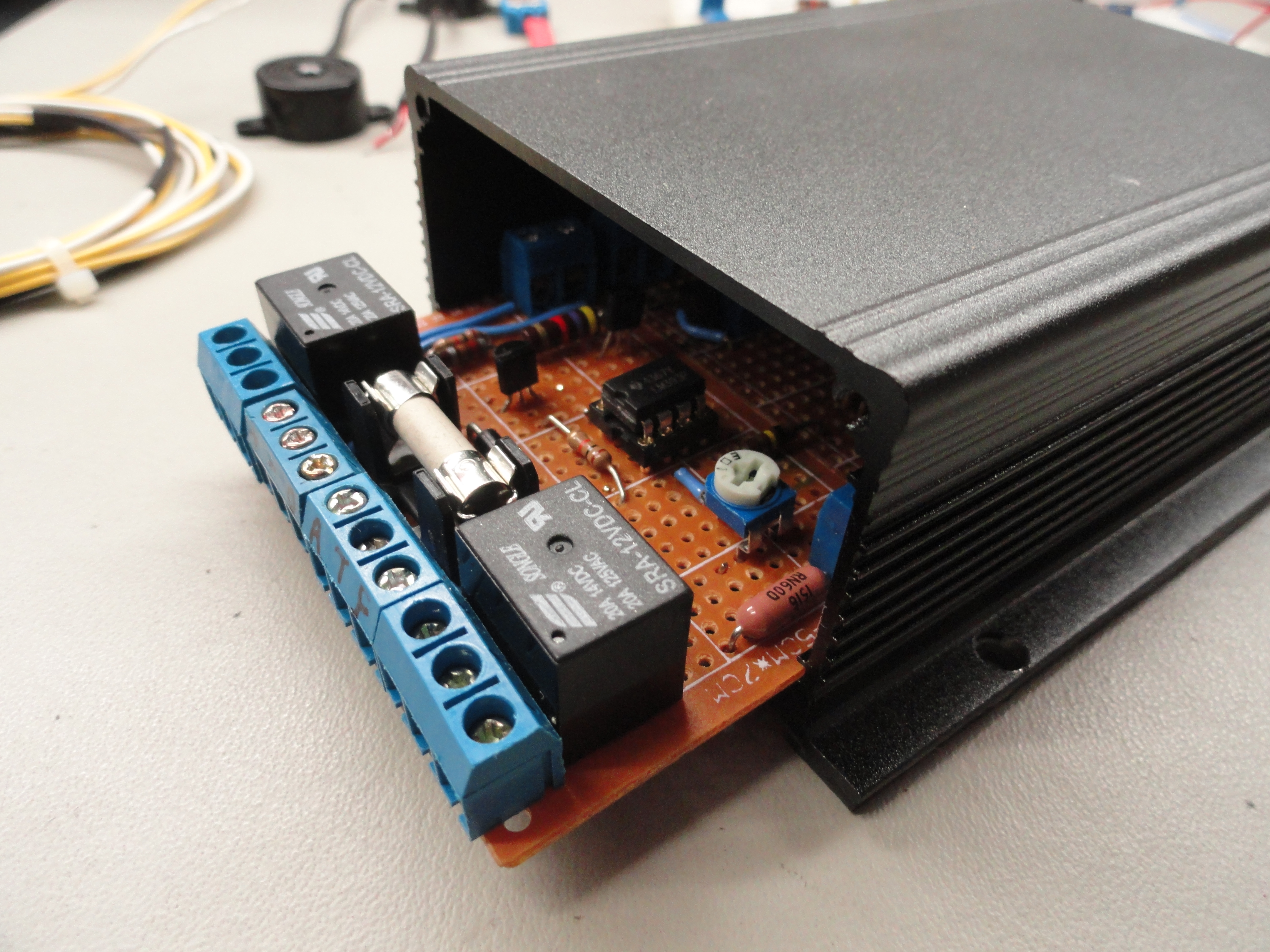

I finally got the circuit in from Thailand yesterday. About three weeks to get stuff from them. A person just needs to have patience which is something I have been saying for three weeks! Anyway, to reiterate what this is all about..
The circuit is very similar to the Ron Francis offering Mike mentioned earlier which uses a thermal resistor to detect temperature as opposed to finding a place in the water jacket to put a sensor. As it comes from Thailand, the thermistor could have a larger lug to bolt it down to the Thermostat Housing, which is my idea for where it could go. It is useable as is, but the lug housing could be larger.
I talked with Alain Stas, an engineer from Brussels, Belgium who works for Vishay Electronics and he spent enough time with me to understand Thermistors. The ones they suggest are here:
http://www.vishay.com/docs/29118/ntcle203.pdf
These radial lead devices can be housed inside of a tin lug housing and then high temp silcon to hold them down to the lug housing. Then, the two leads are connected to a box inside the cab. The Water OverTemp portion of the circuit is basically just this small board that controls a relay that energizes when the lug temperature reaches a certain point. Energizing the relay will control a Piezo Buzzer and an LED to inform the driver of the Overheat condition.
The nice part about this little circuit is, it also can control an electric fan if you so choose. The temperature is adjustable from 120F to 240F via a small pot on the circuit board. The Thermistor is OEM standard equipment on some new vehicles so the technology is widely accepted as well. At this point I have everything I need to make the first prototype for Oil Pressure/Water Temp and Charging. If anyone has any ideas on what else a warning circuit should cover, let me know.

What a journey this has been! After testing all of the components that make up this system, everything is working correctly and reliably. I was able to go back to a 5 pin relay since the Water Temp Circuit has its own on-board relay.
The system is adaptable to suit those who want warning lights, or those who just want sound. I updated the article but there is more to be corrected and updated in the coming days.
http://devestechnet.com/Home/WarningSystem#WaterTempFinal

I would love to hear from some of you enthusiasts about the idea of using a lower amperage rated relay to drive a higher amperage rated one. I found a very small (1.25" wide, 1.5 inches long) SIX DOLLAR circuit board that senses temperature, once it reaches the adjustable threshold, engages the 10 amp relay and whatever is connected to the relay is activated. VERY cool.
However, I was talking to SPAL this week and their 16 inch fan requires a 40 amp (surge) relay and then a 30 amp slo-blo fuse to make it work properly. You would think maybe the aforementioned circuit would be insufficient. However, what if you use that little $6 circuit and drive a standard Bosch style 5 pin 40 amp relay? So, you have a total of $10 into the parts to drive your electric fan system. Anyone have any thoughts on doing this?

We've been using pilot duty relays to drive heavy duty relarys for decades...it's done all the time.

Good. I wasn't sure but I don't see any reason why not. The driver is the coil, not the relay contacts, so that's great to get that confirmed. Thanks again Mike!

Things got a bit delayed because I wanted to understand completely the circuits that are available, then determine which one to use. Turns out the ready made circuits that are out there are not to my liking. There are two finalists and the first one uses non-automotive thermistor and low ohm values that lead to more failures over time. The other one uses the proper values, but still non-automotive thermistor. Then, to top it off, it is not expandable. I want to add a few things to my circuit, so this means re-learning everything I forgot about electronics years ago. It has been a lot of fun and I am really getting into it.
The circuit I am designing from scratch uses 20 amp relays, automotive grade thermistor, a dual IC Comparator that gives me a second Comparator for expansion, and feedback/hysteresis protection. This route enables me to add the last feature I will include in the Basic system, Low Fuel Warning. So the Basic system will have a Charging System Light, Oil Pressure Light/Audible, Water Temperature Light/Audible, and Low Fuel Warning Light. I will offer it customized for each person's desires. Of course all of the plans to make it yourself will be available first.
The rest of it is pretty much complete, but the low fuel warning is in the works now. It will include the ability for the user to adjust where they want to see a low fuel warning. Since it uses the fuel sender, we will be able to adjust it anywhere from almost full to less than empty! It's a bit tricky working with low ohm values like the fuel sender (0-30 ohms), but this has been a real education and something I really enjoy doing. Thanks to everyone who has been encouraging, and to those for actively helping. It's coming soon, but I want to get this right.

Once the individual circuits were prototyped and tested, it was necessary to put them together in one larger circuit. This was all done from scratch using Proto-Breadboards and lots of small hookup wire. Its not pretty, but a necessary step. Once it was thoroughly tested using the test engine and Start Kart, I am now ready to learn how to use a new program called DipTrace. This program takes your schematic diagram and turns it into a Printed Circuit Board file. Just like Draftsight for drawing out Metal for Laser Cutting, this program configures your schematic so that the circuit is designed the most efficiently, then with PC Board Printer technology, Printed Circuit Boards are made. With the learning curve, etc, I am hoping for completed boards in about a month.
Here are a few pics:
Top side of completed prototype:
http://devestechnet.com/Images/Projects/WarningSystem/WarningSystem0070lg.jpg
Board slides into the enclosure:
http://devestechnet.com/Images/Projects/WarningSystem/WarningSystem0073lg.jpg

Things have sure changed since I was making memory upgrades for the original Atari 800 computer in 1979. We had nasty chemicals and copper boards with etching, etc. Radio Shack was your friend! Here is how it is done now:
http://devestechnet.com/Images/Projects/WarningSystem/DiptracePCB.jpg
No more Archer Etchant! What's more is it takes your schematic diagram, and with a few tweaks allows you to go from the schematic to the PCB. It took me about three days to learn this software, so that means anyone can do it. I am hoping to have the boards in my hands within a month, maybe sooner!
Thanks for the kind words Steve! This one is getting interest from some very interesting places.

Well, I got the Printed Circuit Boards back from Bay Area Circuits. I have been very anxious to get them back and see what stupid thing I did because it is my very first experience with a professional software program that does all of the work for you. Here is what I got back from Bay Area Circuits...
http://devestechnet.com/Images/Projects/WarningSystem/WarningSystem0107lg.jpg
and with the board populated:
http://devestechnet.com/Images/Projects/WarningSystem/WarningSystem0112lg.jpg
I should know by the end of the weekend if the entire system is working as planned. We are getting closer!!

These kinds of projects never go perfect the first time, especially for me. But not to be deterred, I just make Lemonade and move on.
The boards were wired correctly per my schematic, so that wasn't it. I used a different LED for testing that was less sensitive so when I put the correct ones in, the Water Temp light was dim and got brighter closer to the set threshold. I found my mistake and fixed the schematic to reflect the proper route. Best to just wire the piezo to the LED so they both get the same signal at the same time. Fixed.
Then, I had not really thought enough about how to attach the long wires that go to the sensors and the LEDs to the circuit board. The screw type terminals are not good for automotive use because they can loosen with vibration. So plan B was to solder everything down. Sounded feasible so that was how these boards were configured. In just a few days of testing, it became obvious that Plan B wasn't going to work. Stranded Hookup wire breaks at the solder joint too easily. I used to know that!
Plan C is to use soldered in Headers. Two pin ones for the LEDs and a 12 pin one for the main connector. Then, crimp on pins are used that lock into place when pushed in. We used hundreds of different cannon plugs, headers, etc with the same type of connections on C-130's, H3's, H53's, Hueys, and T-39s in the Air Force, so I know that vibration is NOT going to be a problem.
This is just one of the steps that are required when you do something like this mostly by yourself. Had I had an engineering team assembled, it would have gone smoother. New boards are on order, the connectors and everything else is already here, and I am anxiously awaiting the new boards.
That said, for months now I have had my prototype hooked up to my test engine and Start Kart. I find myself looking at the Charging LED to make sure I have the engine revved enough to charge the battery and feel just a little better knowing that if for some reason my oil pressure or water temp goes south, I will hear about it right away. I will be adding to my Start Kart document to add this feature as well. Update in another 10 days or so when the new boards get here.
