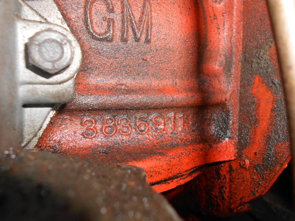

Another possible spot for engine block casting number is to the right of the fuel pump.
If engine is in the truck it is kind of hard to see.
It is under a ledge, I stuck my camera down in the area and took a blind shot. Picture
I have also seen the engine block casting number where it says GM in the above picture.

The location that I mentioned is to the right of the fuel pump.
Front of block area.
Under a ledge. Example: 3703414 Note: The white background where it says ENGINE CASTING NUMBER is covering ledge.
Might be covered in grease/dirt.

Yes, right front block area, not left rear. Passenger front. Like this photo in front of the fuel pump, toward the radiator:

BINGO. Thanks to you all, I found the block casting number right where you said it, "could," be: Right side, far forward, way down and under ledge below the, "GM," cast letters. Lots of wiggling under the truck this morning. Took your suggestion and used my digital camera. Tight spot, but it captured the number:
3733950, which under another chart in another site, corresponds to 1954 or 1955 production 261.

To review your numbers,
55F1017N..... Stamped on flat machined boss to left of distributor.
3733950....... Block casting number Right side, far forward, way down and under ledge.
1954-55 261 cubic inch
3836850....... Head casting number
1954-63, 261 cubic inch
