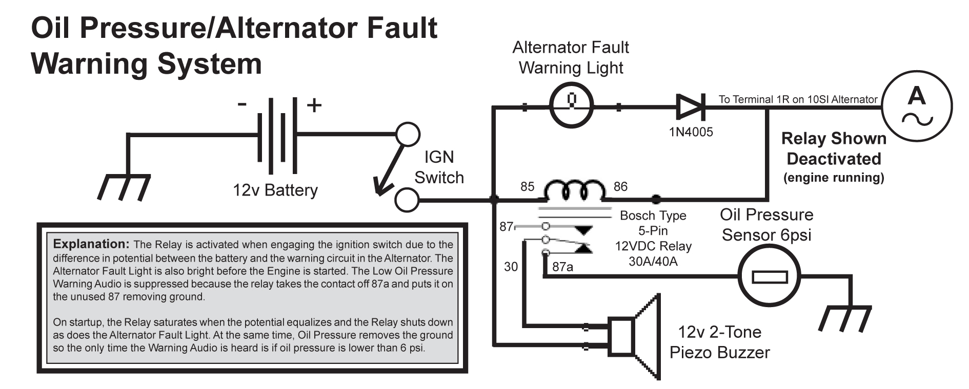

I used a Bosch type 5 pin relay. This diagram show what mine looks like with oil pressure. Term. 86 is not grounded, term. 30 to 87a is normally closed. When oil pressure is 0, 86 grounds and 30 to 87 closes and 87a opens. In my case, I lose power to my fuel pump. In your case, your buzzer would be wired to 87 and you gain power to the buzzer.

Now THAT's what I am talking about! THANK YOU CLETIS!
I will get the parts on order. I was testing piezo buzzers by getting the frequency, then going to a hearing test site, insert the frequency you want to hear and finding the most useful sound. My hearing is awful! Anything above 7000hz is lost on me. My wife can go clear to 12k. The 3900hz standard buzzer is really too high pitched. So, need to research that a bit before putting it all together. The solution will probably be a high-low one.

Ok, so I have the a few of these 5 pin relays, the oil pressure sensor, the LOUD two-tone buzzer and got it all wired up and it works great. HOWEVER...
The circuit as designed will beep when the ignition switch is on and there is no oil pressure. As in when you first turn on the ignition and haven't started it yet. This will not be suitable for anyone the way it is. I need to figure out a way for the circuit to know when the engine is not running. (or IS running) Any Ideas?

Hello Deve,
Woke up in the middle of the night and the circuit we
worked on will not work...... There are three
variables required to make it work properly: #1
Ignition switch on, or "13.8 Volts". #2 Oil pressure sense
"Shorted or Open" AND the missing variable #3 an "Engine
Running" OR NOT running, either a 13.8 V High or Ground
Low. The way the circuit is now drawn it's going to do
the same thing as you originally had it!!....alarm with the
ignition switch on until the oil pressure goes up. You
will "have to have" an engine running signal for it to work
as you want.
I suggest using the alternator charge indicator "light" as
the engine running indication. Most alternators use
the field excitation wire with a Light Bulb in series to the
ignition switch as the Charge indicator. How this
works is: When the engine ignition switch is turned
"on" it applies excitation voltage to the alternator field
winding through the light bulb. The bulb lights up due
to opposite side of the field winding being connected to
ground. However, when the engine starts, and the
alternator spins and puts out voltage, the field winding
will have voltage induced into it which will "rise" above
the ground originally "seen" by the light bulb and the light
bulb will go out! That's how the "charge
indicator" on the dash works....(If the indicator lamp ever
opens, the alternator will not charge!!! because the field
coil is not producing a magnetic field! (That's why
it's called the "field" winding.)
A disadvantage to the car owner, but $$$ to the mechanic
that puts a new 50 cent lamp in, and charges $135.00 for
"rebuilding" the alternator....LOL
Anyway..... To get a "signal"
to inhibit the "Ahh oo ga" horn, you'll have to use the
voltage across the alternator lamp to control the horn
"inhibit" relay! I'll let you figure the
rest out..... Ha Ha
Do you folks understand the difference? I have a LOT of friends just like this. They freely give their information and happily help out the cause because they KNOW that what goes around comes around. God is good and for anyone to think they have a solution better than the time honored tradition of giving of themselves FAILS EACH AND EVERY TIME!

This has been a real learning process. The above post by my friend really was an AHA! moment for me. I was looking all over for a signal that represented engine off vs. engine on. This is important for an audible warning system so that when you turn the ignition key it does not start sounding right away since oil pressure is obviously low. I tried voltages at the coil, HEI distributor, even thought about adding a whole nother circuit. I don't know much about this so the alternator having a terminal made especially for this? ZOOM! Right over my head.
So, this is also an added bonus for anyone who has replaced their generator with an alternator. The new circuit will have a small light on the mounting plate that will have two relays, a fuse, and a small gauge light. I envision mounting this small plate under the dash. You won't be able to see the light from there, but if you suspect your charging system is dead or dying, you know where to look. It would not be hard at all to relocate the light if you so choose.
The small circuit will light the light during an alternator failure, but not provide an audible warning. The only audible warning will be when the oil pressure is too low (6 psi). I prefer it that way so that you can differentiate better. Since I am doing this for everyone, if you have a different opinion, now is the time. The idea is to never hear that ear piercing warning EVER unless something goes wrong with the oil system.

Well, I guess I can forget about 100% of everyone on the Stovebolt doing this! But for all the rest of you, here is the schematic so far. You can purchase the parts on Ebay or usually Amazon has most of it.
http://www.devestechnet.com/Images/Oil%20Pressure%20Alt%20Warning%20Schematic.jpg
For the cost of a Piezo Buzzer (I got the two tone version that puts out 105 db), a Bosch Style 5 pin relay, an oil pressure sensor (you can get a 1/8" NPT Tee so you can keep your old gauge), Light Socket and bulb you are good to go.
I am working on a delay circuit to keep the buzzer silent between engine on and the time it takes for the oil pump to get past 6psi. It's a second maybe, but still annoying. I also think maybe a 10 amp fuse to protect the circuit from another system in the truck causing a fault. I'll post anything new here as I get it figured out. I think there is about $40 in parts at most. The sensor is the expensive item.
To install it, you will need to find the Alternators R1 Terminal to Ignition wire (it's the alternator warn light wire) and run a new wire to the electric oil pressure sensor.
Anyone with any knowledge of how to delay the buzzer about 5 seconds to be safe, let me know. I will have a complete parts list with prices and everything as soon as I make sure of my sourcing.

Deve,
All you need is a Normally Open Timed Closed realy, your 6psi Oil Switch and Buzzer to make this work.
Power the NOTC relay coil with Keyed 12vdc and Ground.
Wire the relay N.O. contacts and oil switch contacts in series to the buzzer using the Keyed 12vdc and Ground the buzzer and your done. The NOTC relay will keep the buzzer circuit open long enough for the engine to come up to pressure. When the key is turned off the cycle starts all over again
Here's a 10 second relay I found on Amazon

That's a really nice relay Mike! Good instructions for wiring it. Thanks! I have to delay the circuit no doubt. I am boning up on RC Time Constants as we speak so if the components or difficulty are not too great, that is a VERY elegant way to solve this. (https://en.wikipedia.org/wiki/RC_time_constant)
I wonder about availability of that relay in the future? What are your thoughts on that? The price is sure okay!

This style TD relay (8-pin, DIN rail mount) has been around for decads...
Mike B smile
