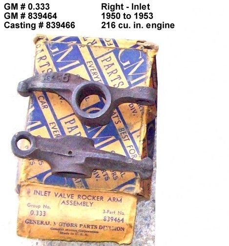

Denny Graham says, The correct rocker is in GP. 0.333, PN. 839464, cast 839465 RH Inlet number three cylinder. For 50-53 all w/216.
Actually the casting # is 839466.
Photo of GM # 839464
photobucket
http://i669.photobucket.com/albums/vv57/glp0329/839464/Right_Inlet_GM__839464__zpsh1kqyh3g.jpg
photobucket
Dan's Obsolete
in
Chinook, Montana
phone: 406-357-2615
has ( 2 ) GM NOS Rocker Arms - GM part # 839464
Chicago Auto Parts
in
Saint Anne, Ill.
phone: 815 - 614 - 3122
has ( 1 ) GM NOS Rocker Arm - GM part # 839464
Wow this is great!! Would much rather just call up and order one (then wait around on a classified ad), but I didnt think that was possible.
Just to be clear, I need the rocker arm for the #2 cylinder, third pushrod in from the front. Just want to be sure there was no confusion because you wrote 'number three cylinder'.
Thanks

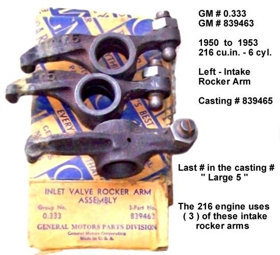

If it's the intake of No.2 than it's a Left hand intake rocker.
Look in the shop manual and parts book. A Left hand intake
rocker for a 50-53 216 is pn. 839463 and should have a
839465 casting number.
dg

The Left - Intake Rocker Arm is GM # 0.333 - GM # 839463
with a casting # of: 839465
Last # in the casting # is the " LARGE 5 "
photo @ photobucket
http://i669.photobucket.com/albums/..._Intake_Casting__839465__zpsabfom9f7.jpg
