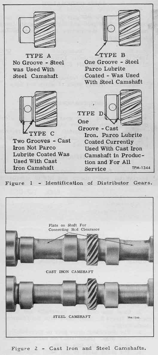

The 216 probably has a steel cam and should use a distributor with a steel gear. The '55 distributor probably has a cast gear designed for a cast cam. I don't know if there is any problem with running a cast gear on a steel cam.

In later years Chevrolet sold the 403 distributor as a replacement for all years, so I figure they felt the cast gear was fine on a steel cam. Never the other way around though.
My Blog
Thanks, Dave. I was wondering.
