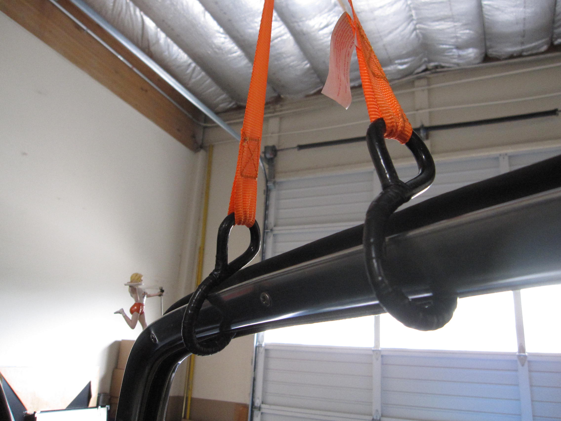

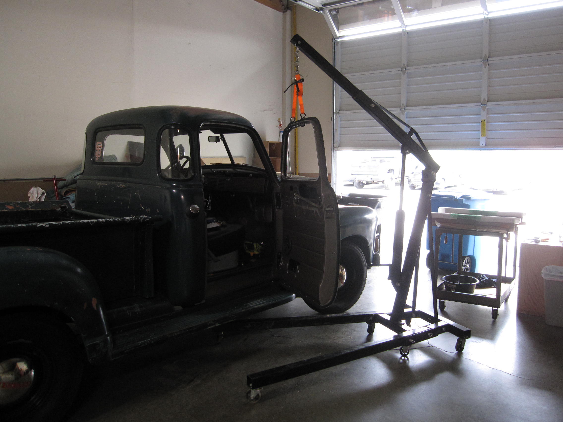

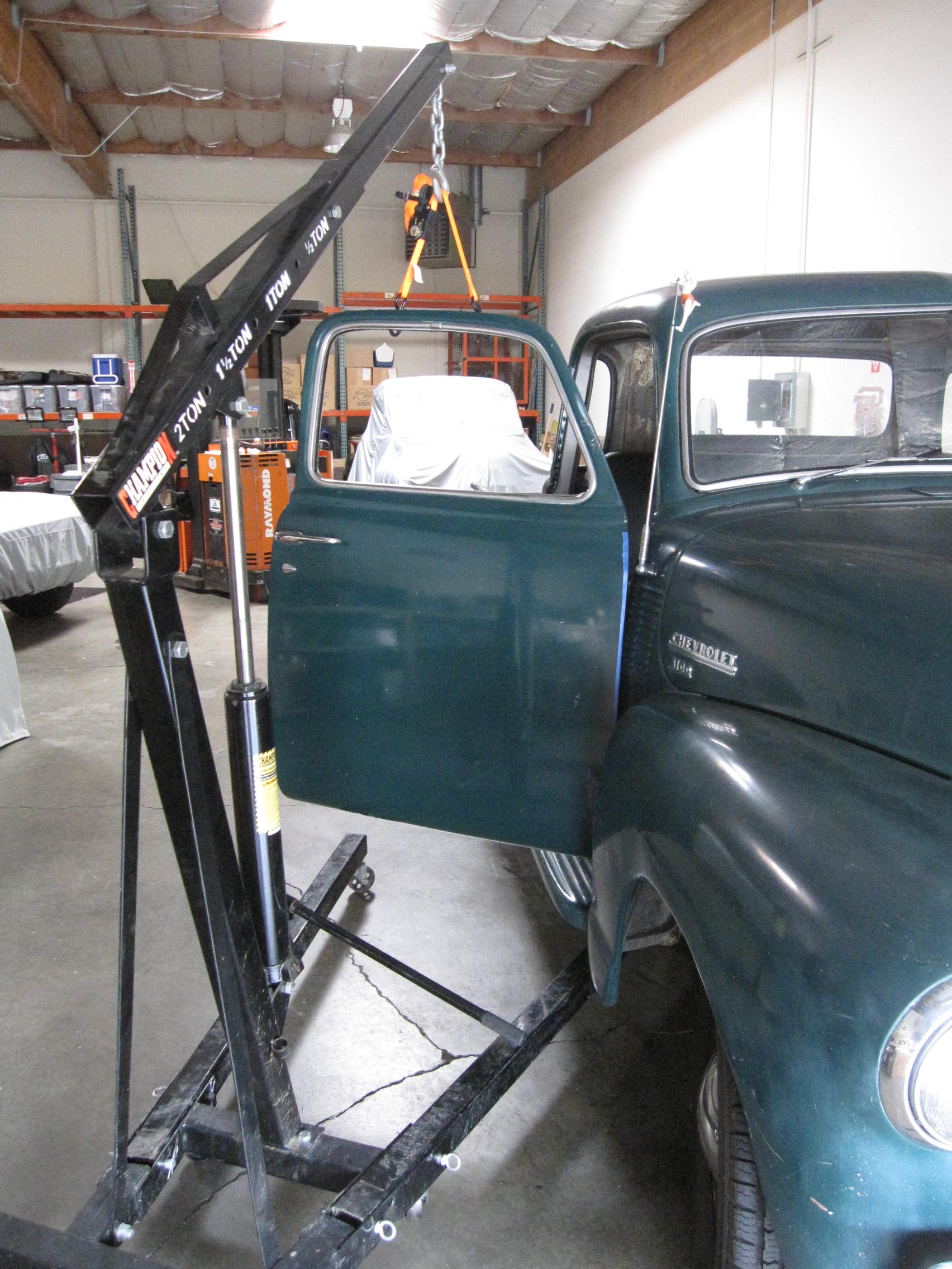

Ready to install my passenger door after installing new door weather stripping and rebuilt hinges. Felt it was too much work welding up a fancy door dolly for a floor jack application, when I have a cherry picker, sitting there, lonely, nothing to do.
http://cmaynard.com/Truck/TruckDoorDollyA.JPG
http://cmaynard.com/Truck/TruckDoorDollyB.JPG
http://cmaynard.com/Truck/TruckDoorDollyC.JPG
Craig

Jeez, I wish I had a cherry picker laying around... I could of saved myself from welding up a door dolly for my floor jack!
It looks like you could even open and close the door for testing if the hooks were on the exterior.

Thanks Craig- That'll be clutch when the time comes!

I did have to open up the hooks a little with heat to allow the ends to slide up into the glass channel without having the loops touch the door's surface. CASO, I think the hooks would interfere with the cab if you attempted to close the door while being supported. Maybe not? Maybe so?
Craig

It 'appeared' to me it's doable with a little more Hook modification. It sure would speed up the process. ( if time was a factor)
