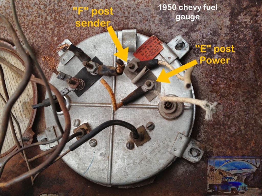

Now i need to rewire the fuel gauge-fuelsender , but i thought it was supposed to be wires like this:
12V source - 6V resistor - Fuel Gauge IN
Fuel Gauge OUT - Fuel Sender Unit.
And then the fuel sender unit would be grounded. But now i saw that there are to connectors on the unit. I guess one (outer) is for ground and the other (center) is for to connect to the gauge?
picture of sender
the wires that are connected don't go anywhere.

Gus, can you post that diagram that Denny posted on another Gas gauge post? That picture that came from the GMC Jolly site. That would help the poster here and you are good at saving/posting info. If DG see's this, maybe he will post. A great diagram. Raoul: your sender connections, as you know, are way rusted. The gas gauge gives many people problems. The sender is available I believe ($30). Many gas gauge problems are the wiring, especially ground.
Posts: 8,983
Sir Searchalot
Sir Searchalot
Posts: 8,983
YES
Seems like a question about the fuel gauge comes up about once a week.
I believe even a fifth grade student could understand the workings from this
drawing that is circulating on the internet:
http://www.pbase.com/dennygraham/image/159356931
You’re working with a basic series/parallel circuit in which the current runs thru
the first winding (load) then splits into two legs for the current to flow to ground.
One is thru the second winding in the dash gauge to ground.
The other path is to the Sender winding to ground.
When the wiper at the sender is in the empty position it offers no opposition to the
current flow and since current follows the path of least resistance all of it will seek
ground through this path and none will pass through the gauge.
When the wiper at the sender is in the full position it offers a very high resistance to
current flow in relation to the meter and the vast majority of the current flows through
the gauge sensing coil and the needle show full.
If the circuit is open between the gauge to the sender or if the sender is stuck in the
full position then the gauge will read full.
If the circuit is shorted between the gauge and the sender then no or very little current
will flow through the Gauge sensing winding and it will read empty.
That’s basically all there is to it.
Denny Graham
All gassed up in Sandwich, IL
Posts: 8,983
Sir Searchalot
Sir Searchalot
Posts: 8,983
Gus/DADS50 has documented the whole process and trouble shooting procedure with pics and videos. He is your man on your AD. He will be glad to travel to Sweden if you pay the fare. wink

Thanks guys, again, and as usual. I have seen the diagrams and everything before but couldn't find them when i used search. Sorry about that..
Im going to take out the sender, clean her up, and while I'm at it i'll clean everything behind the seat aswell (Found an old rusty american FORD(!) can with break fluid.. The truck is imported to Europe 1996 or something, haha!) then connect everything and see if the gauge works.
Two more question though.
1. If i test the gauge without putting it back in the instrument panel, do i have to ground the gauge housing too? (thats how it looks like on the wiring diagram) Nevermind, i read DG's quote that DADS50 posted.
2. Does the gauge have to "stand up" to make it work? (is it sensitive for gravity?)
Thanks a bunch guys, you are truly the best!!

What do you mean by "connectors"? Pictures? A conductive, insulated metal strip is connected between the rheostat/coil (thru the housing) and the center terminal on the sender mounting flange. If you were to open up the housing (can), I'll bet the coil is disintegrating/rusting. New sender is needed. Jim Carter is capable of handling currency conversion and foreign shipping. He typically only charges actual shipping and no handling and is a sponsor here.
Joined: Mar 2014
Posts: 195
Joined: Mar 2014
Posts: 195
Thanks Dads50, but thats the outside,
i do now know how it works. The ohm meter i've got shifts between 40 and 180 even if i don't connect it to anything so i can't measure anything with it.
I opened the housing, the coil was intact, and works. The metal strip that goes from the mount to the housing is gone, the linkage inside the sender is totally broken and cracked, so tried to solder some stuff together but now its not reliable. So i'm going to buy a new sender i guess.

There is a spring foot wiper that wipes across the curved coil operated by the float arm. As you know.
