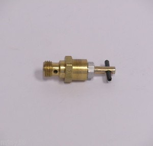

Yes, your main jet is in there and is not adjustable. I've never seen one with a bolt like that in the hole though. Usually it it screws in all the way to the head like this .
An adjustable jet
