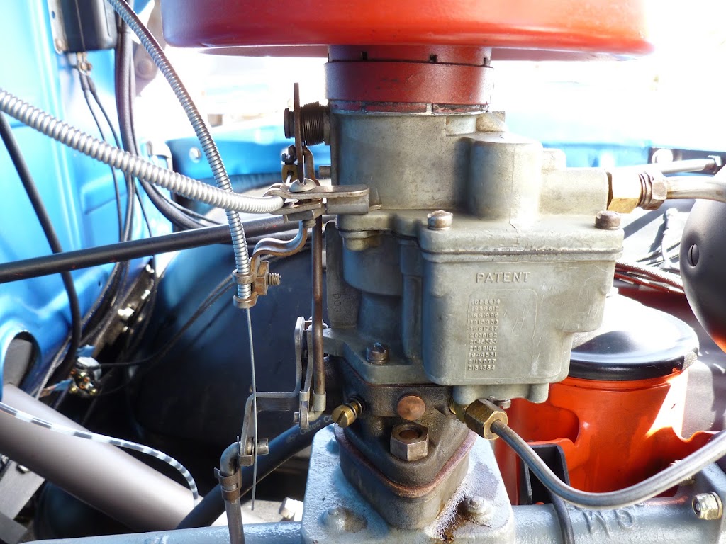

My choke wire is fixed to the carb with a hoseclamp, but its moving when i pull and push the choke button. I have no idea who did that and why, but how is it supposed to be installed? Does anyone have a picture?
This is a carter, but you'll get the idea
...picture...
...picture...

Now i see some parts are missing for the manual choke on my rochester B carb. first of all the bracket. i made a new one, so the wire comes from the right angle.
Now i miss the small square block with the screw that holds the wire from the choke knob. (the last owner/fixer just fixed the wire by bending it and using a cable tie) what is that called? I need to order it from ebay, or maybe there is a easy way to fix the automatic choke, probably buying a new thermostat or something. I do like it to use the manual choke though

That would take some modification to use as a choke stop on your Roth B
Might be better off finding a junk carb core on ebay or request in the parts wanted section of the forum.
