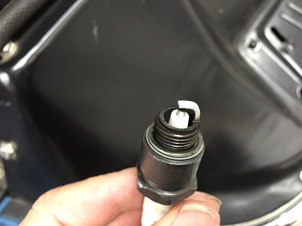

Here's a pic of the number 1 spark plug
....spark plug pic...

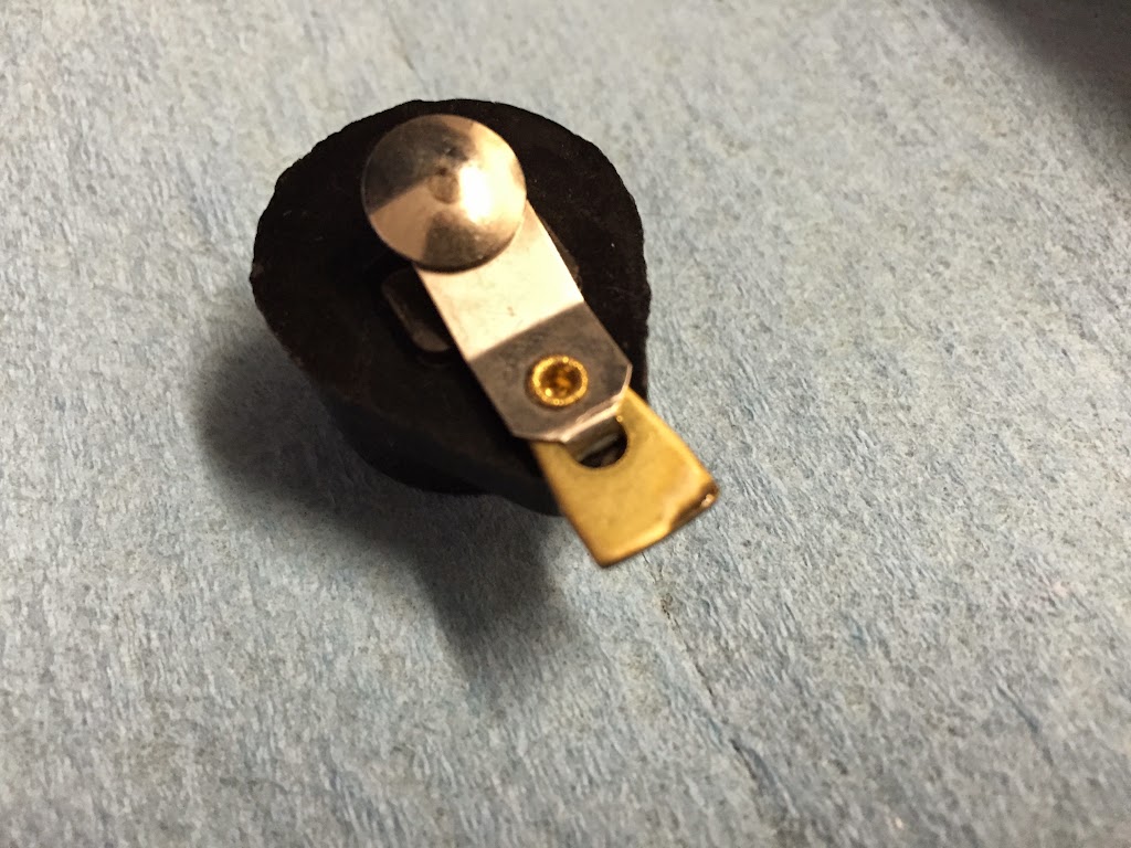

Well I had a bit of success this morning
I removed the ...Rotor...
And ...Cap...
I'm not sure if that pattern is normal?....
I noticed quite of bit of wobble in the whole distributor. So I removed it.
I did not notice to much wobble between the shaft and body but there was a little bit.
...pic...
So I decided at add the disc and spring from pre68dave blog.
Then as reassembled I noticed a lot of play in the vac advance. So I tried to tighten the screw the holds the to pieces together and found out the small fine thread bolt was stripped and would not tighten.
...video...
My guess is this was causing excessive play once the distributor was installed?
I had a spare vac advanced and reinstalled the distributor with new cap and rotor.
I lost my time but once I got her retimed the truck sounded much better. I set my rpm to 450, advanced the distributor to max vac reading, and was able to turn in the mixture screw a bit.
Tested spark at each wire and had a nice constant spark.
Went for a test drive and it ran much better and sounded great.
At one stop I came to I had to rev the engines just to make sure it was still on. It was.
Thanks for the suggestions
I think this came down to excessive play in the distributor.?

Looks like you nailed it- - - -Sometimes the little details make a huge difference! Any variation in the firing impulses at the distributor doubles the timing change at the crankshaft. Since the crankshaft turns 2 degrees for every degree of distributor rotation, it doesn't take much wobble or wear to result in big timing changes between cylinders.

Follow up question on spark plugs
In the truck now I have delco r46sz spark plugs
With new cap rotor and wires I was installing new spark plugs
They are autolite 303
I noticed the autolites are shorter. The probe will not be in the cylinder as far.
...pic...
Autolite on left, delco on right
Does that distance make any difference?
DADS50 #1081667 01/26/2015 9:38 PM
Posts: 29,746
Posts: 29,746
The important distance is the thread depth, which appears to be the same for both plugs. Extended-tip plugs put the tip of the insulated electrode out into the incoming fuel mixture, which tends to make the tip run cooler. The Delco 46 series is one step "hotter" than the original-equipment plug, (original was a 45,IMHO) so that should keep any deposits burned off the extended tip. I don't see a problem with running the Delco plug.
OOPS! I misread which plug you have now- - - -the short Autolite, right? If it's the equivalent of a Delco 45, you're still OK. The short plug with the equivalent heat range to a Delco 46 will be good for short-trip driving. It might tend to cause a little detonation on a long haul under heavy load.

The delcos r46sz do show the white deposit I posted a pic of in the ...third... post.
Not sure why I put those r46sz in

In the good old days that plug would have been dark brown or sooty. Too rich. Tough to "read" plugs with modern fuel. About what you would have expected with a miss on # one.
