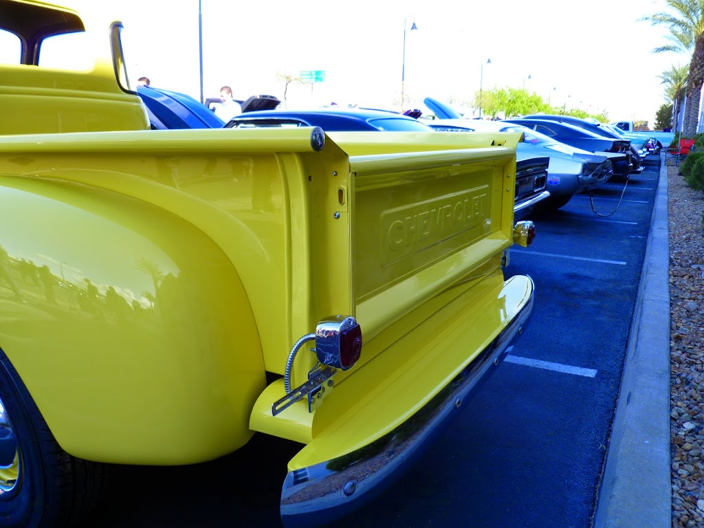

Cadee #1081273 01/25/2015 2:18 AM
I've seen this type at a show I was at
...pic...
If that's the type your referring to it looks like they use the rear Bumper bolts
Cadee #1081328 01/25/2015 4:55 AM
I think the part shown by DadS50 is the one sold by Patrick's.
http://www.patricksantiquecars.com/images/page16.jpg
