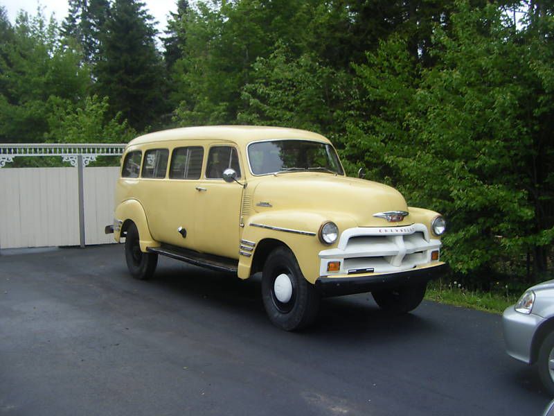

Yes that is a beautiful 1-ton Suburban but you won't convince me it came from the Chevy factory that way.

http://i104.photobucket.com/albums/m177/49Cosmo/1954suburban1ton_zpsb338483c.jpg
Cosmo's "1 ton Suburban" looks more like a 1 ton panel van that has been a victim of the old "ambulance van" conversion by an aftermarket coach builder.
http://oi59.tinypic.com/2lw8vna.jpg
No such thing as a 1 ton Suburban.
Suburbans were only offered in 1/2 ton.
The stainless fender strips were not avail. on any suburban.
Only panel vans were eligible for the stainless fender trim package.
The rear quarter windows are too small to be factory openings for suburbans.
The dead giveaway would be detailed pictures of the inner body sides around the rear quarter windows.
Guaranteed to be a converted 1 ton panel van.
