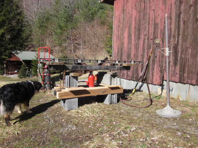

I had pretty good success with my "Hillbilly Bumper Press".
Here's the picture.
The bumper is 5/16 thick. With a combination of heat, and 8 lb hammer, and pressure from a 20 bottle jack; I was able to massage out most of the dents. With this method, correcting twists is a little bit more difficult.
Dog help is optional.

Nothing wrong with that! I thought about trying it myself. Maybe trying to correct the twists at the ends, with the bumper still on the truck.
But, if I take it off, there is a shop here in town that have big presses ect. They specialize in working on heavy equipment, such as dozers and log skidders with bent or broken parts.

If you have a shop that will do it, go for it. I hunted for a long time and just got the run around. I left my bumper with a local body shop with a frame rack for 3 months with no action.
If a place had a big press and a resourceful person, it should be less than an hours job.
