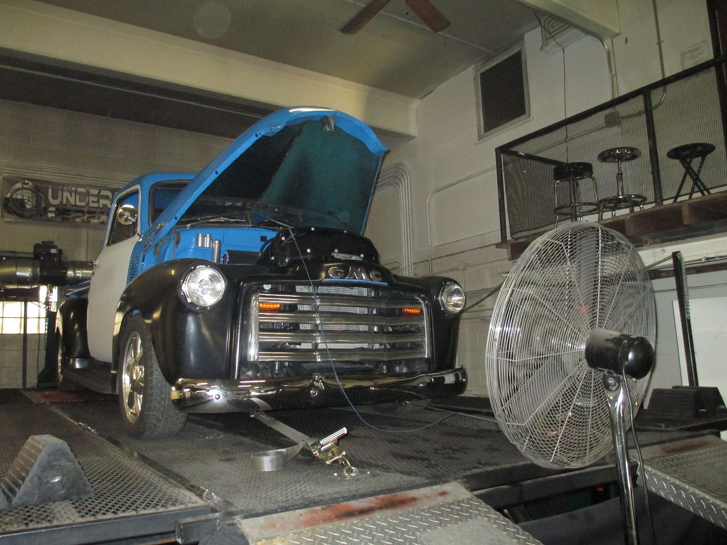

| | | | | Joined: Dec 2004 Posts: 128 Shop Shark | | Shop Shark Joined: Dec 2004 Posts: 128 | Here is a complete build thread on a trailblazer to AD truck swap.. AD on a trailblazer chassis and here it is complete on the chassis dyno dyno time
