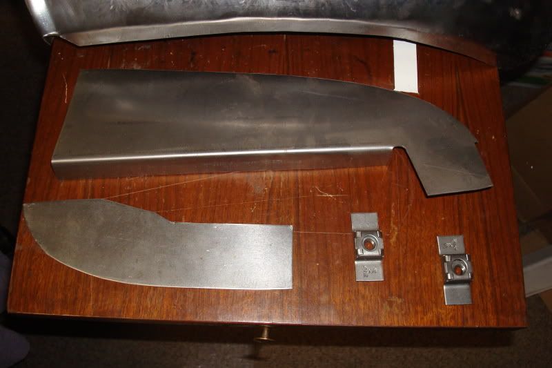

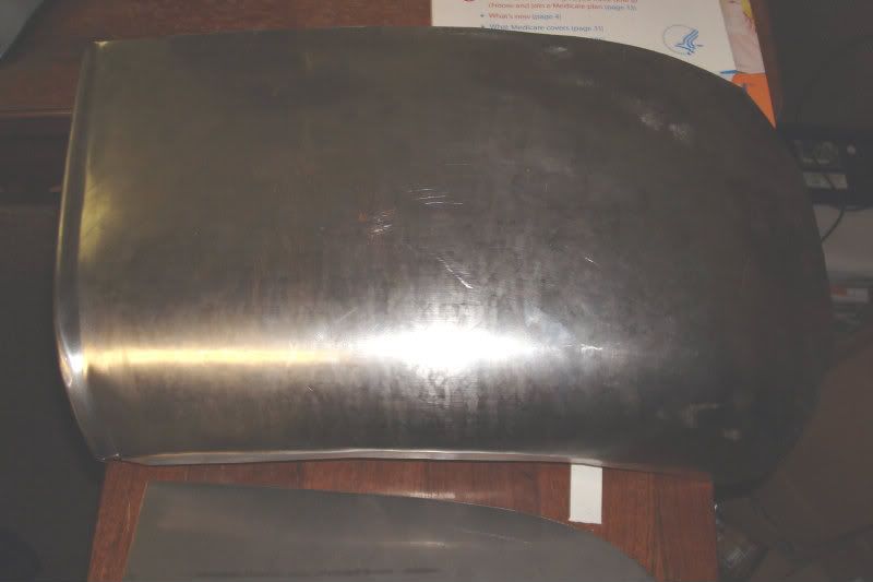

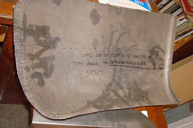

| | | | | Joined: Dec 2010 Posts: 64 Wrench Fetcher | | Wrench Fetcher Joined: Dec 2010 Posts: 64 | Im also needing the rear corners for my panel. I contacted Jim Carter and asked if the rear corners had the bead rolled into them to match the bead around the fender area and they told me that there was no bead rolled into them.  Would the lower area between the door and rear fender have the bead rolled into it to match also? I have sent metal man a message on his website but it keeps coming back to my email saying there is an error and its delayed. Does anyone know of another way to contact him? Thanks for any help | | | | | Joined: Aug 2014 Posts: 218 I have more zippers then a pair of cargo pants | | I have more zippers then a pair of cargo pants Joined: Aug 2014 Posts: 218 | Carters panel patches are all hand made by MetalMan [Wheelwright Restorations], who would no doubt make any other patches he could get good patterns for - contact info here or usually can find him on e-bay Bill he also makes that odd ball one off sheet metal stuff that fits ONLY the one ton AD panels. He made my repair panels that go behind the rear fenders, that are a bit longer then the 1/2ton parts. AND yes they do have that round lip by the fenders. I have sent metal man a message on his website but it keeps coming back to my email saying there is an error and its delayed. Does anyone know of another way to contact him? Ray Stanley Wheelwright Restorations 92 Pine Street Wheelwright, MA 01904 1-413-477-6467 Hope this helps you........joe
~ Joe Donate Blood, Plasma, Platelets and Sign Your DONORS CARD. The Life You SAVE Might Be Someone You Know and LOVE. Two possibilities exist: Either we are alone in the Universe or we are not. Both are equally terrifying. ~ Arthur C. Clarke | | | | | | Oldog in Md. Unregistered | | Oldog in Md. Unregistered | Ray is my first stop when it comes to this type of fabrication , top notch service and you it is going to fit ...first time Dan | | | | | Joined: Dec 2010 Posts: 64 Wrench Fetcher | | Wrench Fetcher Joined: Dec 2010 Posts: 64 | Thanks Joe for the info and pics. I appreciate it. And also thanks Dan
I will be giving Metal Man a call | | | | | Joined: Aug 2014 Posts: 218 I have more zippers then a pair of cargo pants | | I have more zippers then a pair of cargo pants Joined: Aug 2014 Posts: 218 |
~ Joe Donate Blood, Plasma, Platelets and Sign Your DONORS CARD. The Life You SAVE Might Be Someone You Know and LOVE. Two possibilities exist: Either we are alone in the Universe or we are not. Both are equally terrifying. ~ Arthur C. Clarke | | | | | Joined: Dec 2010 Posts: 64 Wrench Fetcher | | Wrench Fetcher Joined: Dec 2010 Posts: 64 | I got my rear corners today from Ray and the look great. VERY happy with them.
Thank You for the info on how to contact him,it is very appreciated | | | | | Joined: Dec 2010 Posts: 64 Wrench Fetcher | | Wrench Fetcher Joined: Dec 2010 Posts: 64 | Wanted to ask if anyone has any tips or advice on how to go about getting the corners in?
